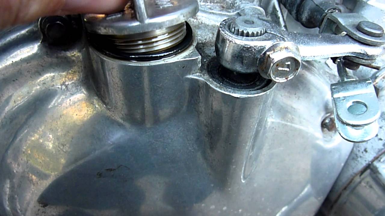

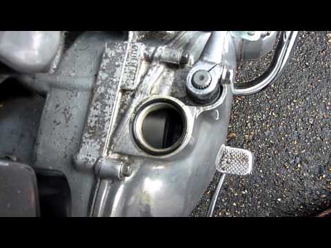

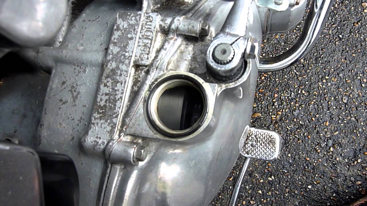

                              Try this if you suspect the clutch:
                              Open oil filler cap.
                              Sit on bike.
                              Start bike.
                              Pull in clutch.
                              Put it in first.
                              Hold front brake hard.
                              Slowly release clutch until it bites.
                              Does the noise go away?
                              Yes: then it's clutch related (nut lose, rattling clutch hub bearing, rattling basket back plate and back plate springs or lateral movement of the whole clutch on the spline).
                              No: look somewhere else.
                              And here's the video of this test described above:
