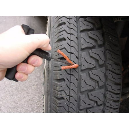

                Those sticky rope things , can someone point to one on uk eBay ?
                I don't know what they are or what I'm.getting ?

                  Just google: tyre repair kit
                  You can find many brand name versions of these in every auto parts store.

                    Many thanks.never used em so never understood sticky ropes.
                    Now I do.

                        I've used those sticky rope things alot on cars and they work.I never even take the wheel off and even keeping the tire pump on to keep the tire stiff while inserting the plug...
