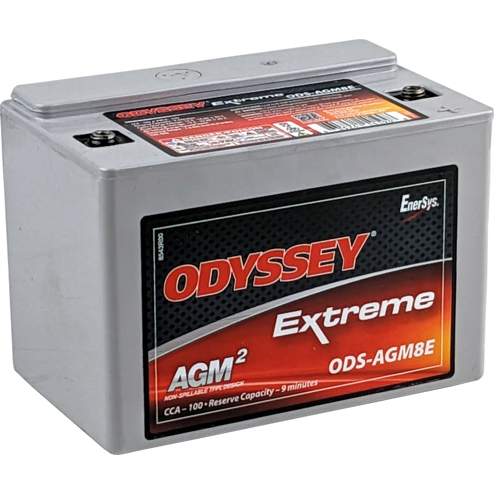

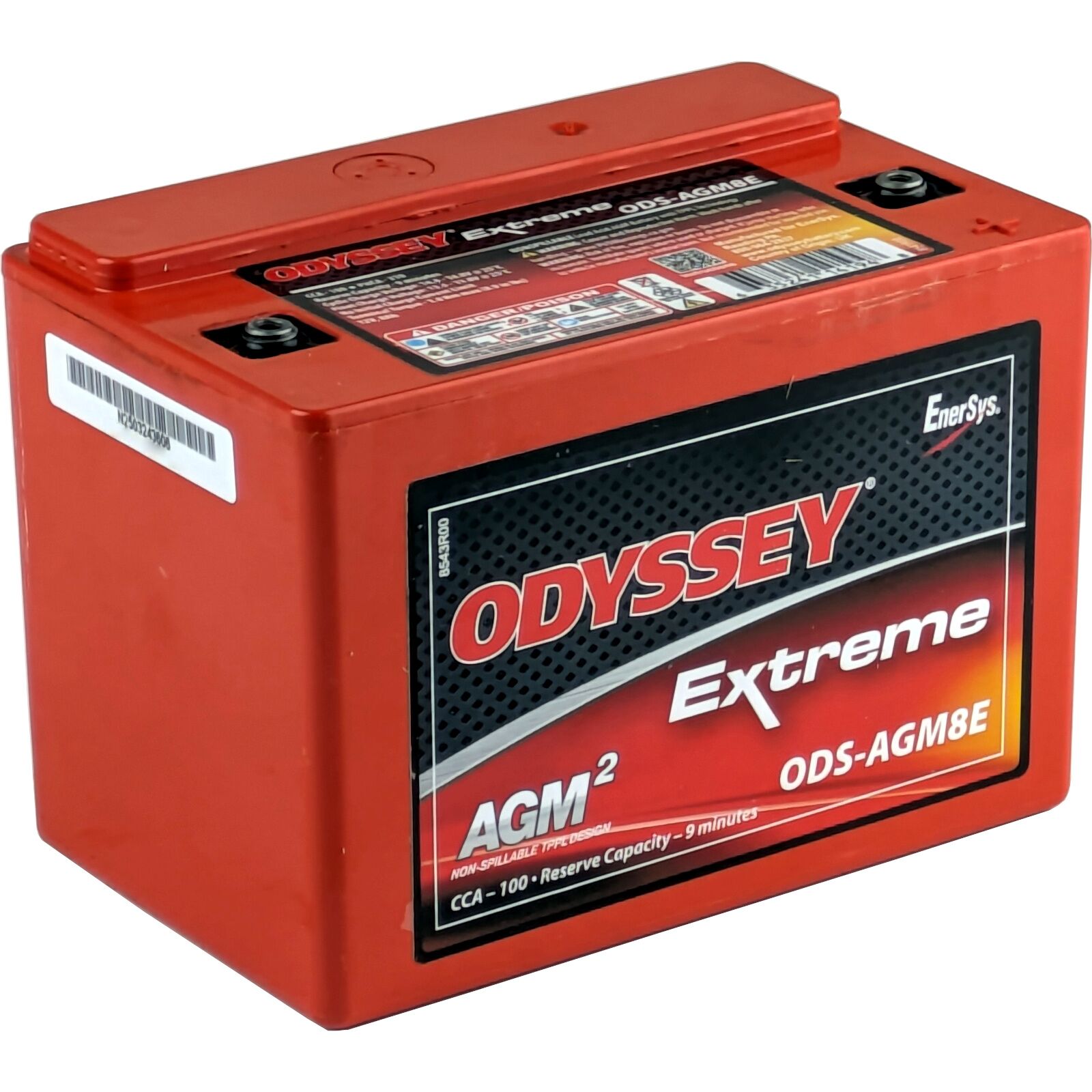

              Westco is an excellent brand -- I believe they're rebadged Panasonics.
              Absolute top of the line are Odyssey batteries:
              Welcome to OdysseyBattery.com - the official manufacturer's website for the revolutionary ODYSSEY® battery. It has twice the power and triple the life of conventional lead acid batteries, and is ideal for car, truck and powersports vehicles, as well as marine and heavy duty applications.
              A mite spendy, though.
              http://www.batterymart.com/ is a pretty good vendor, and their "Big Crank" batteries have a good reputation.
              My VX800 is wearing a Wal Mart Everstart AGM that's physically quite a bit smaller than the OEM battery, but has the same CCA rating. It was a roadside emergency replacement about a year ago, and it didn't have a bit of trouble even in below freezing weather.

                Thanks i've placed and order for the new battery. It was bit spendy, looks to be a great battery though. Could probally start my car in the summer months.

                  May I ask how much these go for....and is it smaller than the stock battery? They supposedly last more than twice as long, so that's a plus (provided they don't cost more than twice as much!).

                        I payed about $150 w/ shipping, the westco of the same size was $90. Less than 2x as much but not by much. This site seemed to have a decent price, besides ebay, and was recommended on the forums.
                        Check out the deal on Odyssey ODS-AGM8E Extreme Powersport Battery (PC310) at BatteryMart.com
