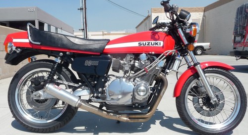

              You recall the GSXR head bolt spacing is narrower than the GS. Not a problem putting GSXR on GS , but the other way around, this is one of the issues.
              The other thing to consider might be spigots. The bolt will be very close to the head and the spring retainers will save those threads. Also the spigots push the whole pipe a bit further forward and can add just the needed header clearance. On my ED, I still had clearance for between f fender and exhaust but it is close.
              I found some V&H spigots on eBay (a few years back now) and had them machined to reduce the standoff. Here is a picture using hex head stainless bolts into teh head.

                  For track racing that V&H megaphone is probably not the best for cornering clearance. Generally the pipes that come straight down the middle are better and so pulling the pipe is not an occasional affair especially for racing. You say you are going to studs, that will take a load off of the poor threads in the head at least. Still a pita to pull the exhaust.
                  As I recall the MotoWorks SS pipe has spigots and would be something fitting to your build instead of the megaphone.
                  Like this:
