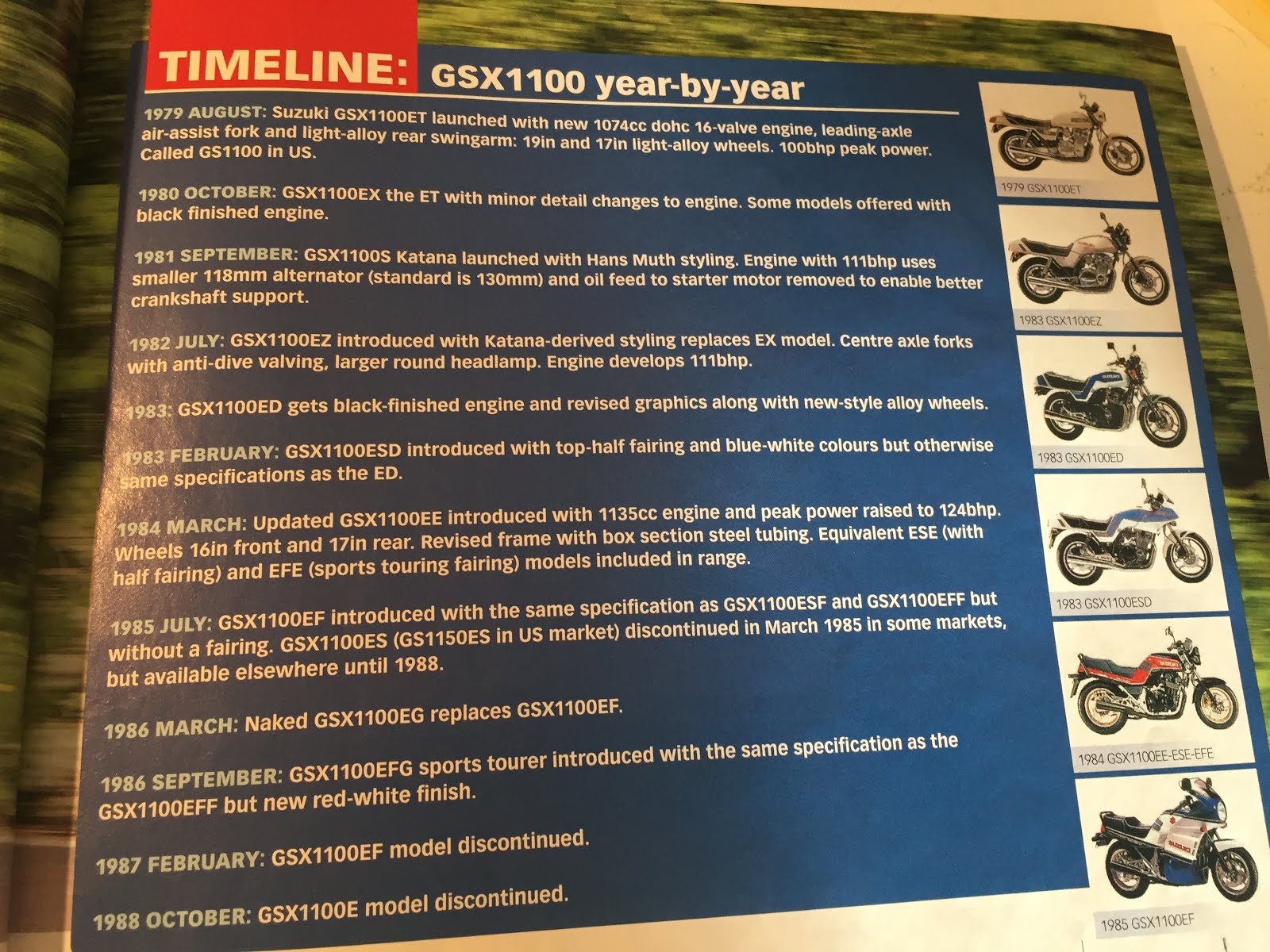

      Hello and Welcome
      My understanding is as follows:
      Essentially all engines that look like this:
      are 124 hp.
      The previous generation found on the Es, ETs and EZs which look like this:
      are of lower hp of 111.
      This recent magazine article shows the progression:
      That's the European story. I think you might be confusing your dates. As pic above, anything 1984-1985 would have been the EFE engine with 124 hp.
      However, there may also have been regional variations in the US, such as models made specifically for California or Canada that had restrictions or modifications for environmental reasons, which may have reduced HP on the 1984-1985 EFE engines.
      This is helpful:
      http://www.suzukicycles.org/GSX-series/GSX1100E.shtml
      and concurs with my analysis.
      This isn't so helpful as I think the 1984 GSX1100 EF (known in the US as the GS1150 EF) is incorrectly listed as having 114 hp:
      http://www.suzukicycles.org/1980-1989/1984a.shtml
      Hope that's a start anyway.
