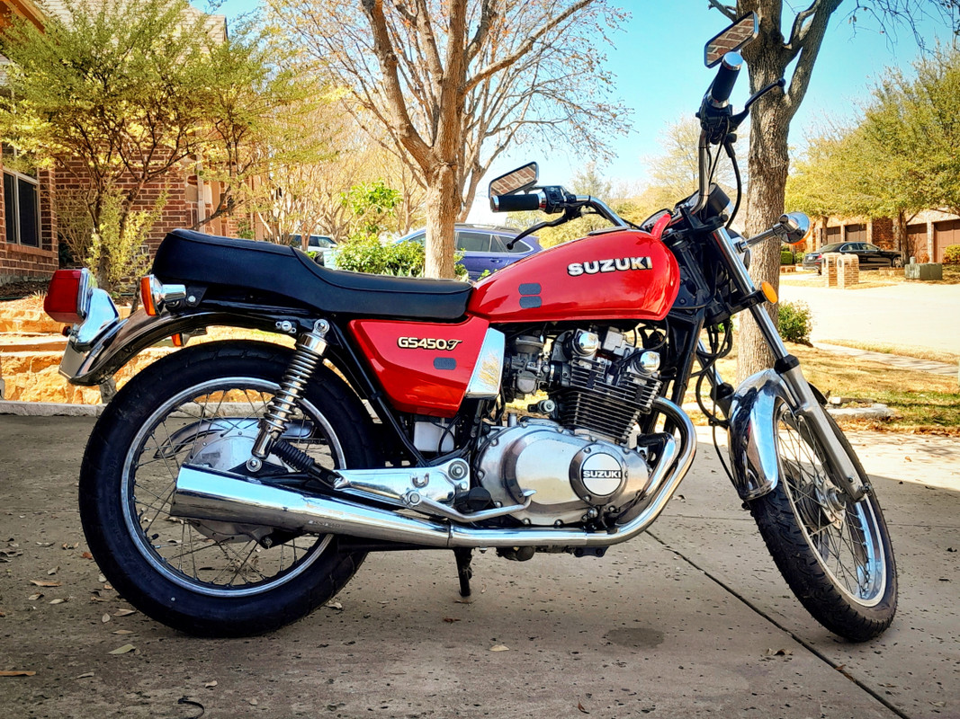

                          today was the test ride, everything was working great. i'm a new rider so i didn't go more than about 25mph, back and forth up my street, but the engine is good, brakes, clutch, trans, everything's working really well.
                          only two problems left.
                          1. slight oil leak, seemingly from the chain tensioner gasket on the back of the head. I'll get around to it. maybe when i get the broken valve cover bolt fixed.
                          2. fork seal leak. I think I fixed this. I used a seal mate to clean the seal, and there was a medium ish sized scrape on the stantion tube. so I took some 2000 grit to it and buffed off the sharp edges and it seems to be holding now. i guess time will tell.
                          3. i'll throw in one bonus problem. the right muffler's in the process of rusting out. I'll let future me replace the exhaust someday. for now it isn't causing any issues.

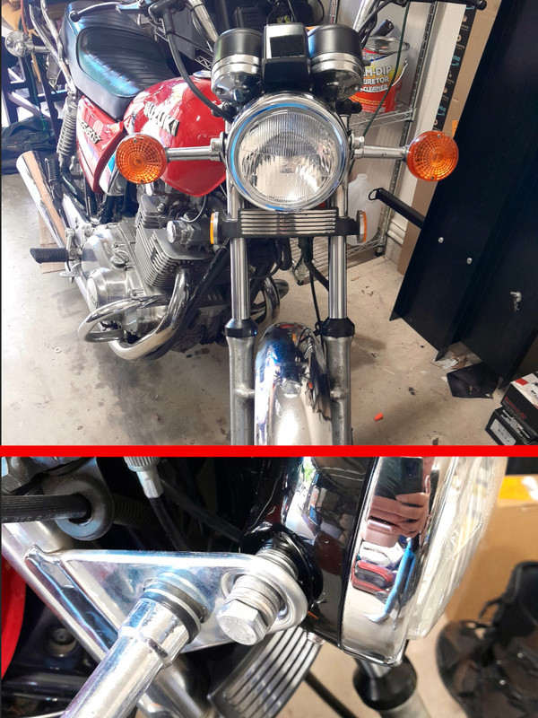

                              ~500 mile update. everything's running just fine.
                              It's raining today, so instead of riding, I installed a different headlight bucket (emgo 66-64313D) so i can run automotive lamps instead of sealed beams - which they don't apparently even make my size of them anymore (some kind of honda special 6 1/4 bulb). It came with a halogen, and it does look a bit brighter than the incandescent that the bike had stock. I do want to try out some led bulbs since I have an sh775.
                              it didn't come with hardware, so i ordered some stainless, and i'm glad I got a 50 pack of washers because i needed them. I knew I would have to shim between the ears. But I took a wild guess on the length of bolt needed and ended up guessing about 10mm too long.
                              anyway, it still looks relatively stock. though it's a bit smaller. only a real GS nerd would notice.
