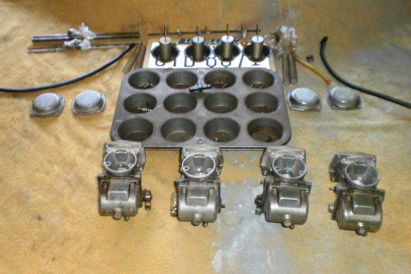

            • ratdude
              My " gone through " carbs
              Well even though my carbs were all good according to previous owner I tore em down any way .
              As stated previously
              3 of 4 pilot jets were clogged
              All 4 pilot jet plugs were long gone
              3 of 4 passageways in the float bowls were clogged up
              2 of 4 main jet washers were the wrong kind
              all 4 CV boots and slides were " clocked " wrong
              And thats probably enough , I wont be going into huge detail on the rebuild process , John Bloemer's guide says it better than I ever could
              ( FANTASTIC guide ! )
              Some early pics
              Just a reference shot I took of the linkages , notice how squeaky clean it is .
              And another
              Early stages of disassembly notice my super trick parts organizer
              Why you need to take them COMPLETELY apart ( looks good , huh ? )
              Later
              Rat
                • 35927
                Nice organizer.
                Just so you know, ... you are not alone.

                  • ratdude
                    So I see
                    Originally posted by Steve
                    Nice organizer.
                    Dang , the mega deluxe one !
                    I shoulda saved up .
                    Giving me workbench envy
                    Rat

                              • 35927
                              Rat
                              Saved up?
                              No, you would have saved by getting some like those.
                              My wife got me those on one of her many trips to the Dollar store.
                              If you look carefully at the first and third sets, you will see that they are doubled up.
                              The pair of two tins that hold six muffins each are a whopping 99 cents.
                              That's right, for just under $2 (plus tax), you can get your own set of "mega deluxe" carb parts organizers.
