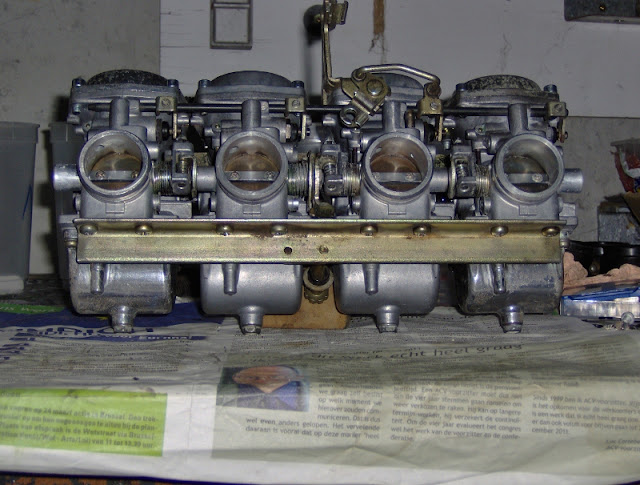

And here are the carbs before and after the ultasone.:clap:

I finished the carbs today.
Ready for the summer.
I know, some parts were not mounted when i took the pics, but they are now.
