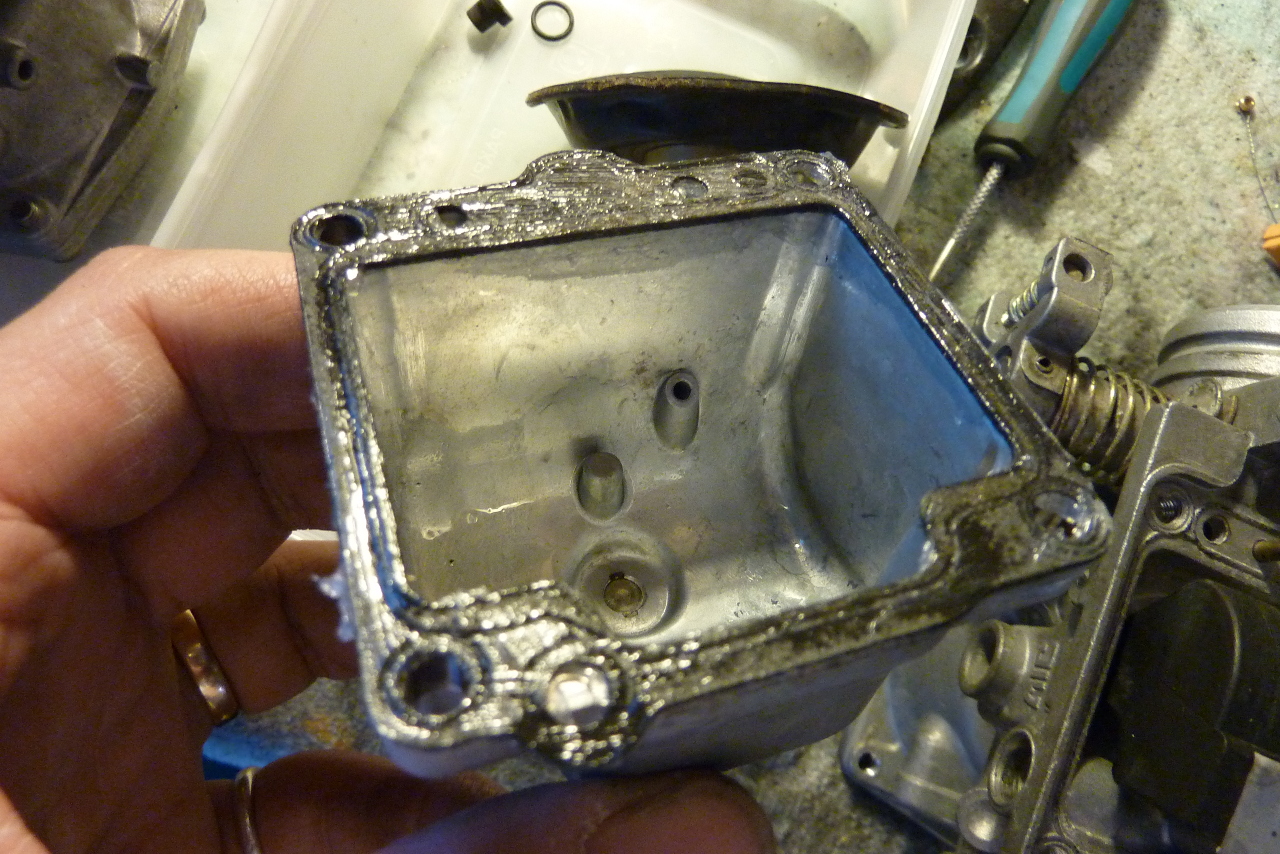

Carburetor Clean and Rebuild
Ultrasonically cleaned them and rebuilt them with all new 'O' rings.
See My GS1100G Road Runner Blog - Carb Strip and Rebuild
Found this stuff in the needle valve filters:
Made sure all passageways were clear.

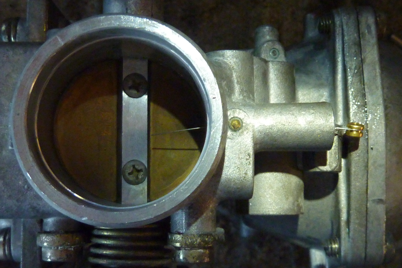

Checked out float heights. They all needed minor adjustment.
GreetingsLast edited by londonboards; 09-04-2013, 08:20 AM.Richard

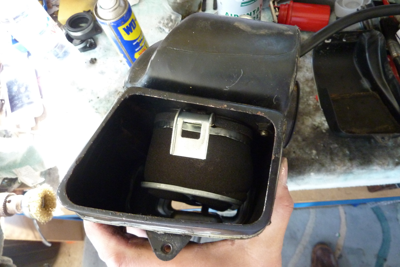

And I also cleaned out the airbox and installed a new air filter.
GreetingsRichard

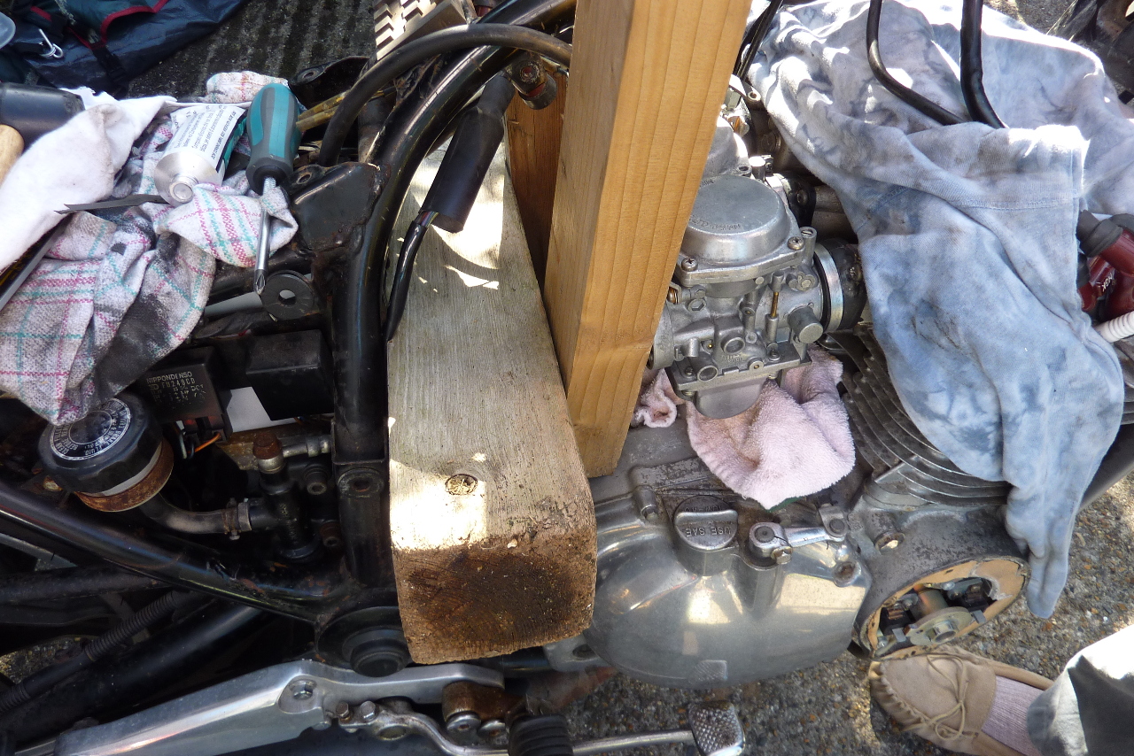

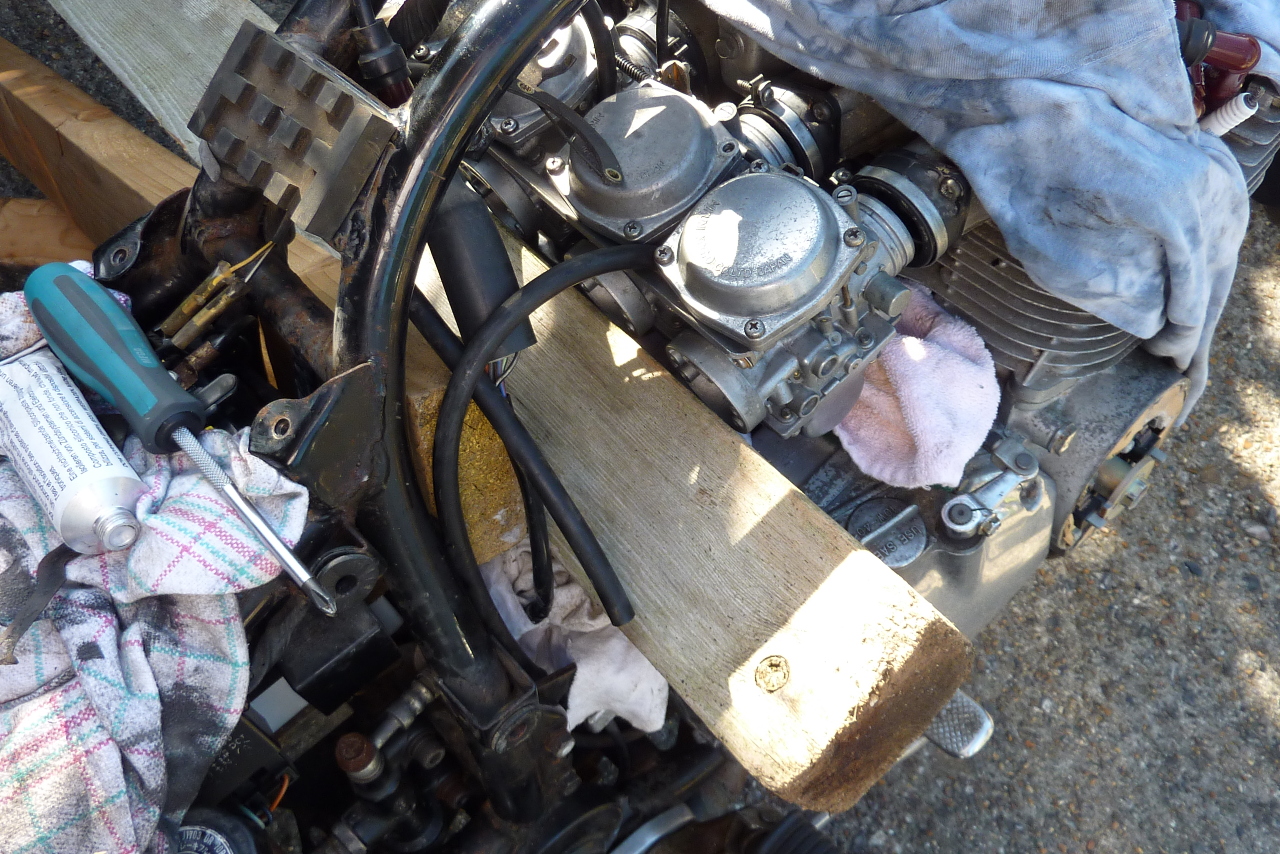

Re-Installed Carburetors
I squeezed the carbs in using planks of wood.
See: My GS1100G Road Runner Project - Re-Instal Carburetors
You need big pieces of wood!

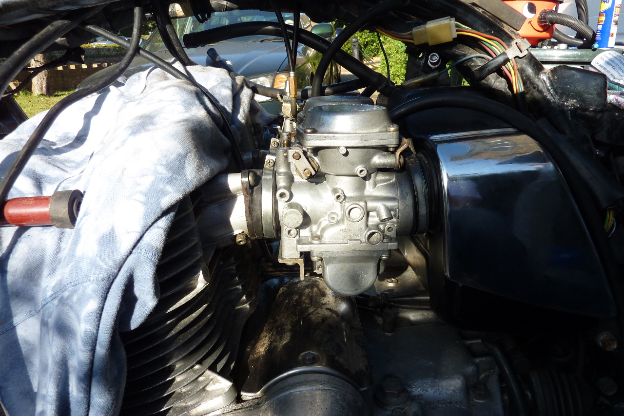

Nearly did it like this:
But then ended up like this:
Then I discovered the choke assembly return spring was in between the wrong carbs. Should be between carbs 3 and 4!
So they all came off again. Then when I put them on again I discovered the intake boots were upside down so, as you can see, the carbs did not fit into the airbox boots. Take them off again and fix.

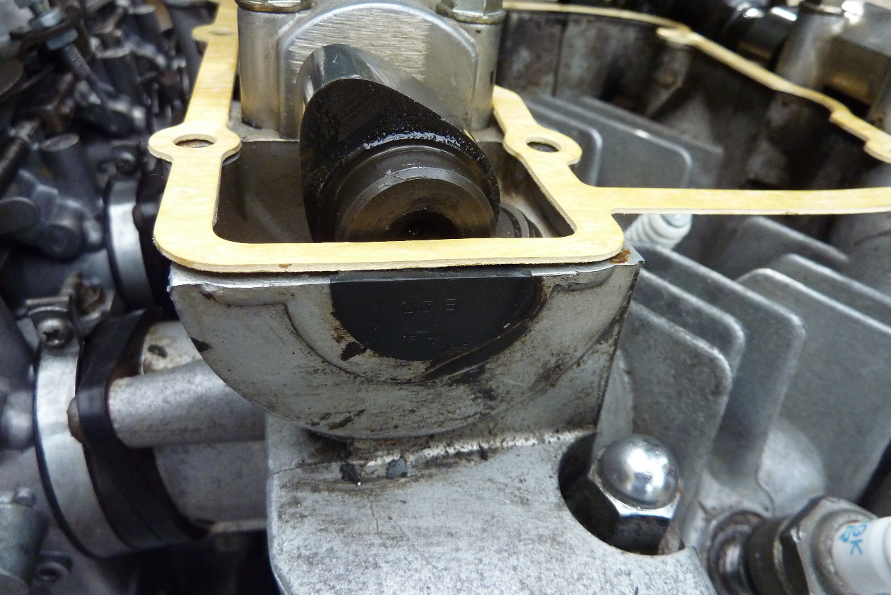

New Cam Gasket and D Plugs
So after doing the valve clearances and to try and stop the oil leak, I get a new cam gasket and D plugs.
See: My GS1100 G Road Runner Blog - Cam Gasket
Check all the surfaces.
and put it all back together will some gasket compound around the oil leak area. That did the trick.Richard

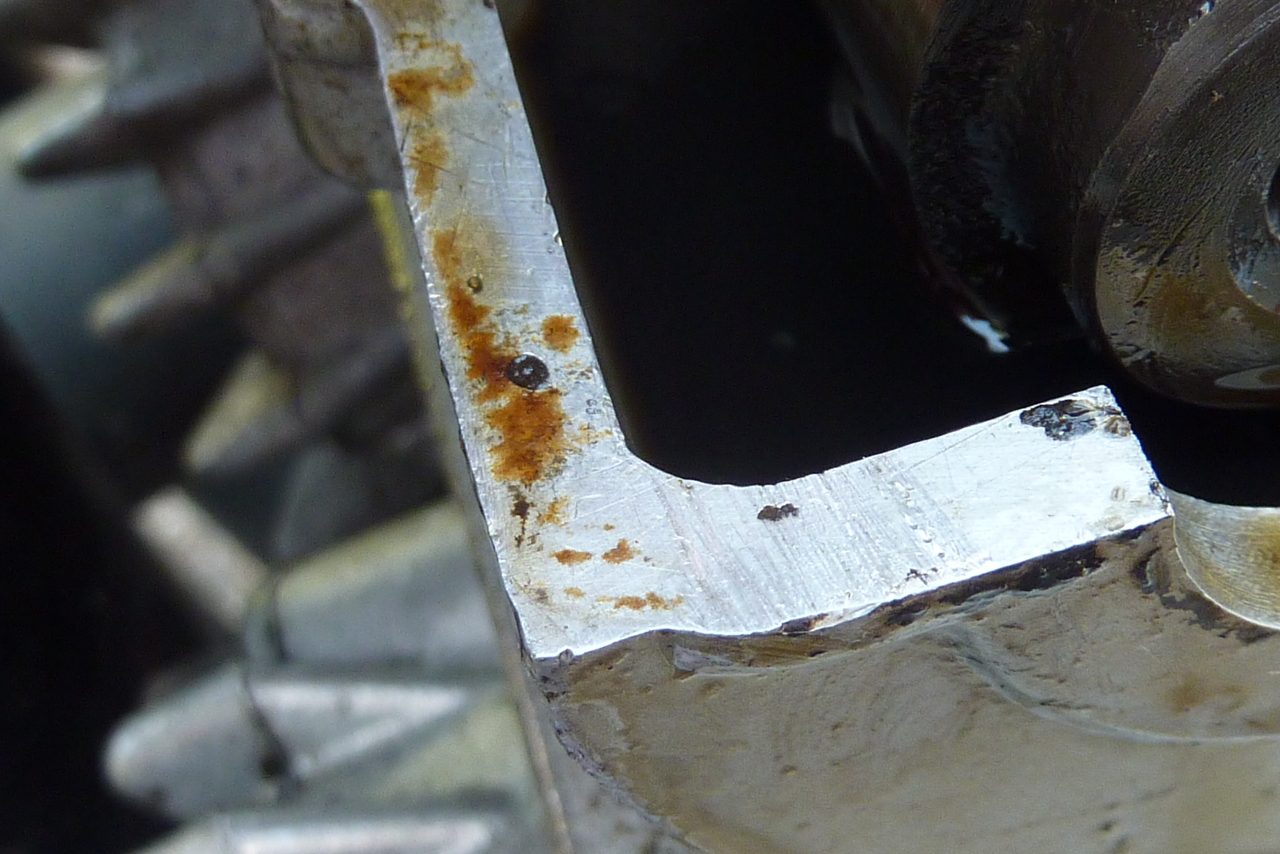

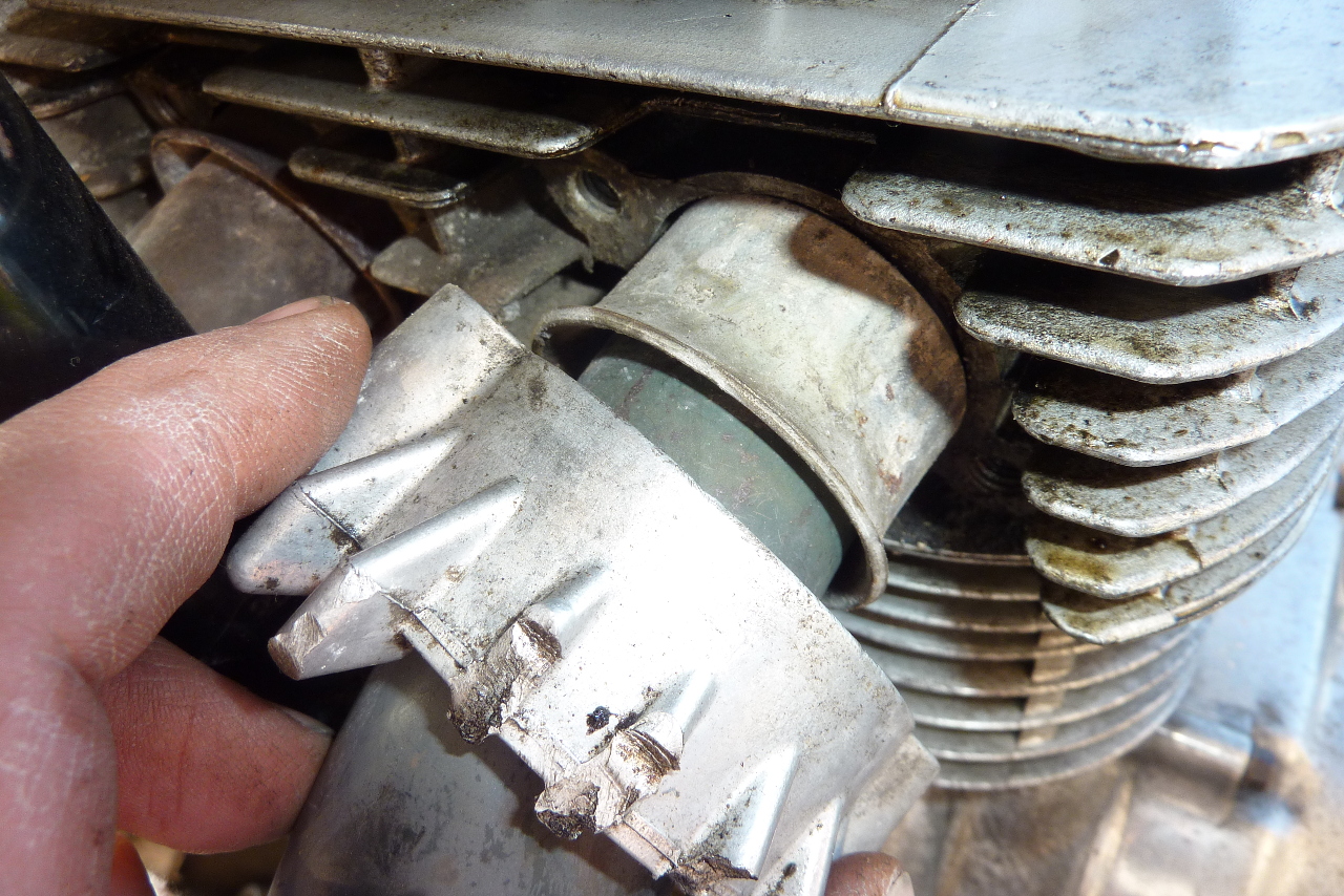

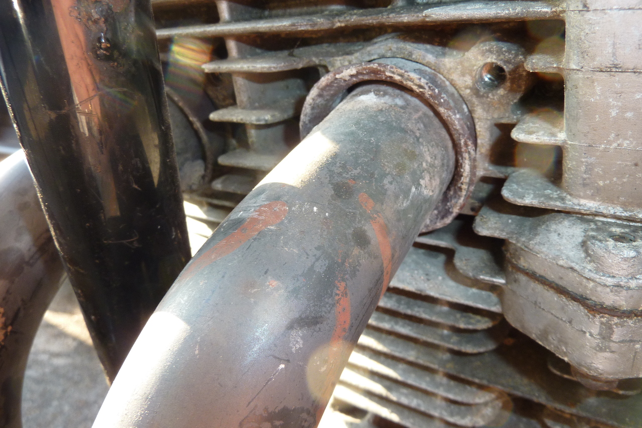

Exhaust Bolts
I wanted to see what was going on with this selection of exhaust bolts the PO has installed.
See: My GS1100G Road Runner Project - Exhaust Bolts
This is what I took out:
See the grey sealing cement which came out. Some one was trying to plug the holes. No wonder it sounds like it's blowing!
Compare this to the set I took out of my other GS1100:
You can see the problem is that the bolts are only biting on the last few threads. They should be seated further down the bolt holes. Why is this .....
..... extra large flange spacers don't allow the bolts to seat properly.
These and the bolts are going to have to be replaced at some stage.Richard

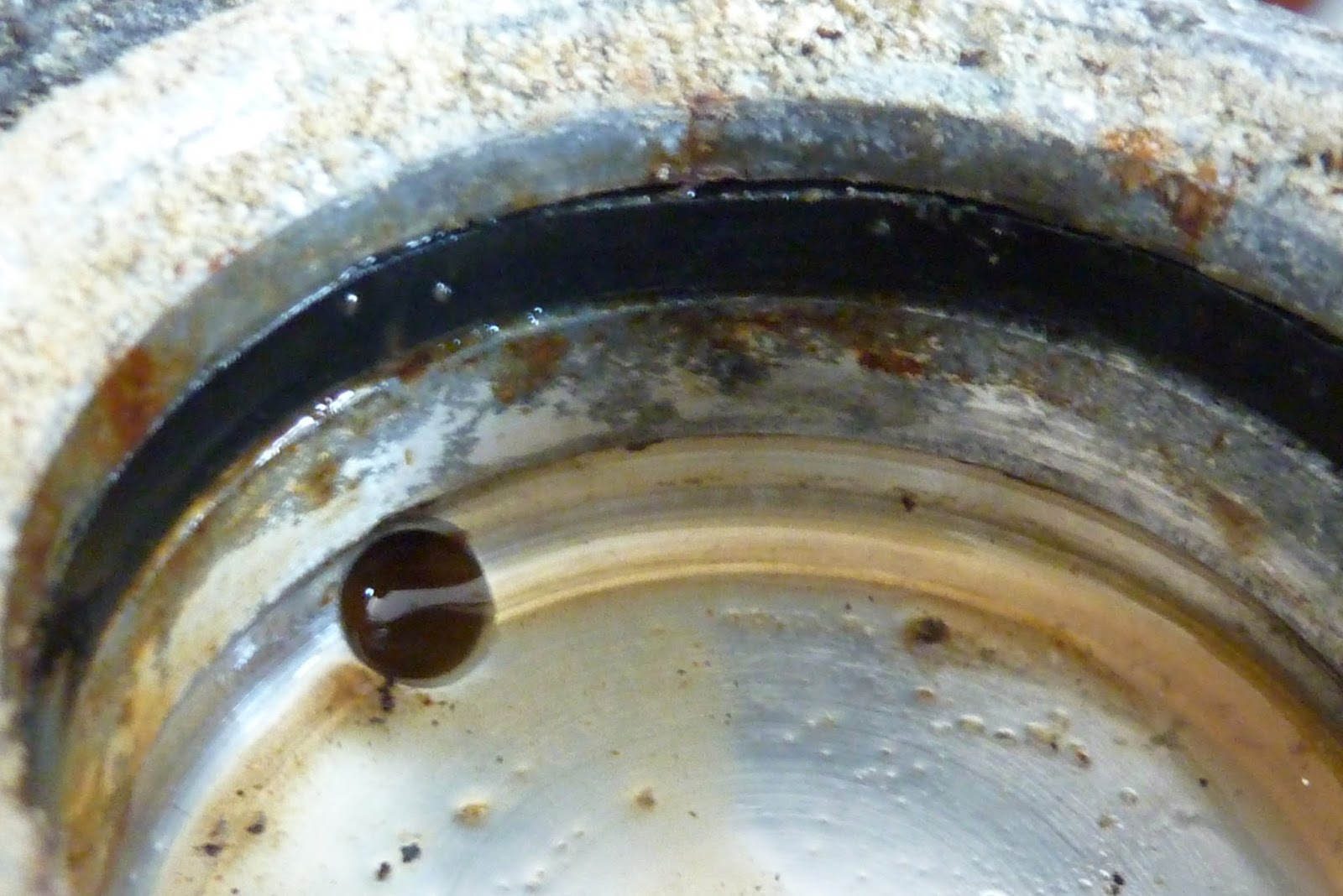

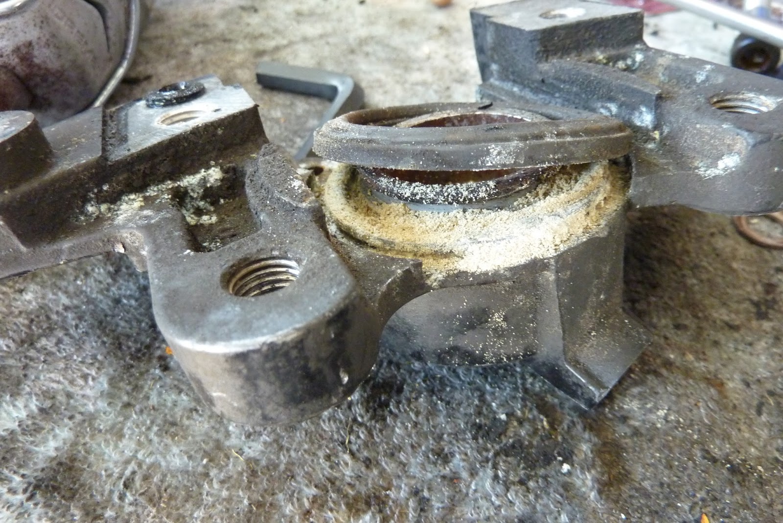

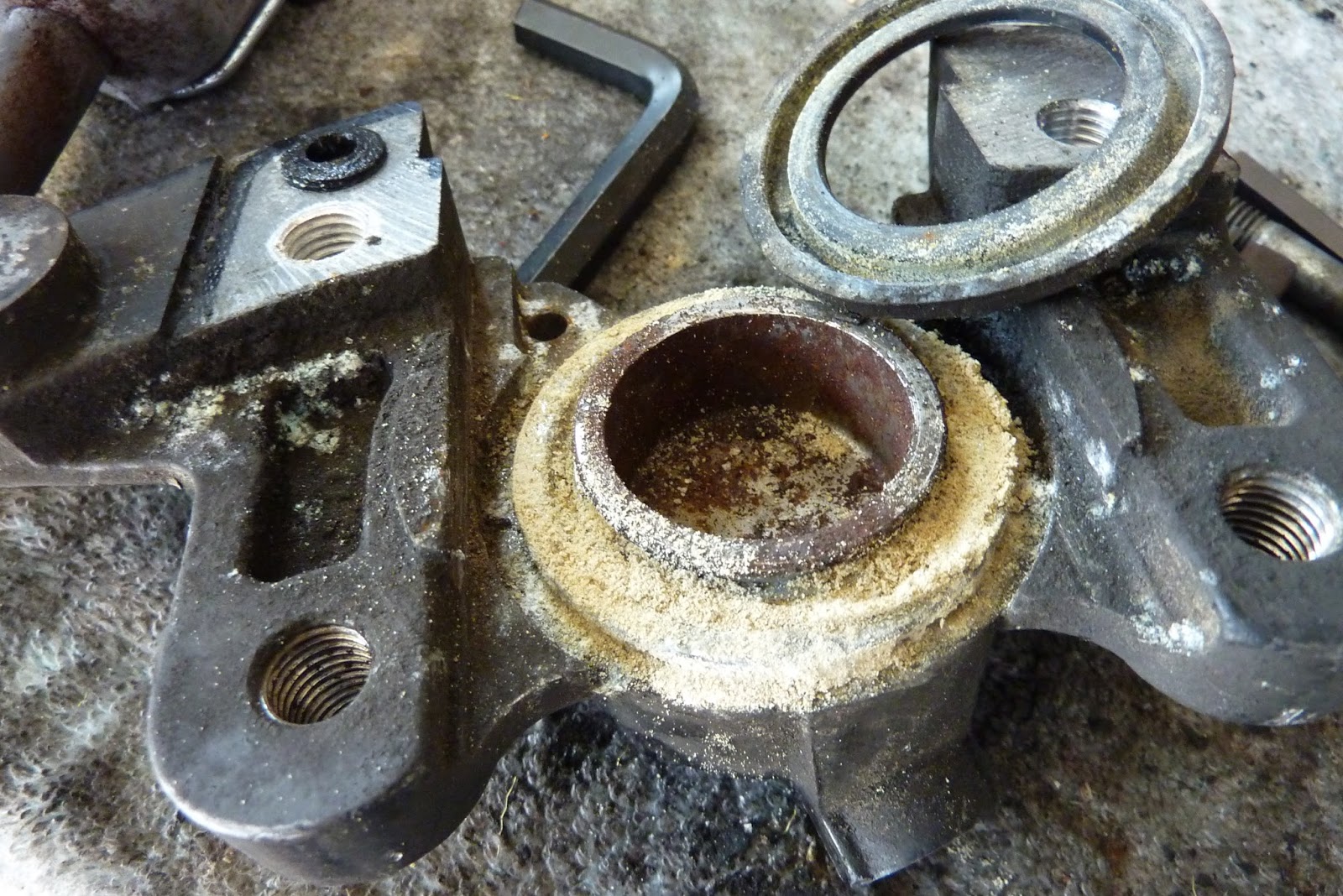

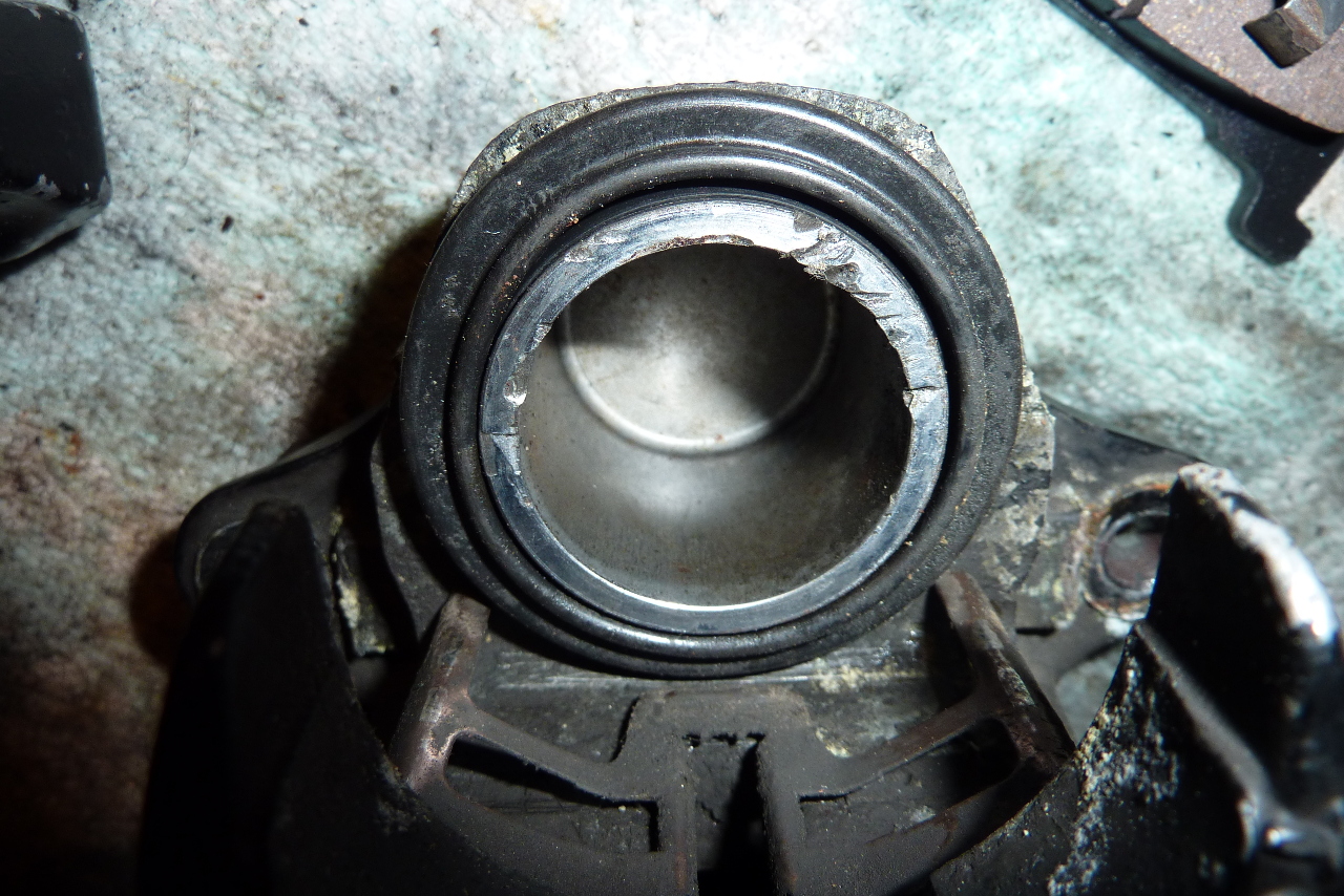

Why Don't My Brakes Work?
I thought I should have a little investigation to see why the bike was not stopping:
And look at the carnage a PO had inflicted on these poor pistons:
So a good clean up, new rubbers and lube and away we go.
GreetingsLast edited by londonboards; 09-11-2013, 05:19 PM.Richard

Missed this before...
You are measuring to the wrong spot on the float. You need to measure to the bottom of the step, not the top.
Doing a great job overall. Love the photos.
Richard, the RSPCA will be after you - turfing all those animals living in your brakes out of their home......
Are the pistons salvageable? You can tidy up the ends - as long as you don't take off too much material. It's gouges and pits on the walls that turn them into fishing weights.79 GS1000S
