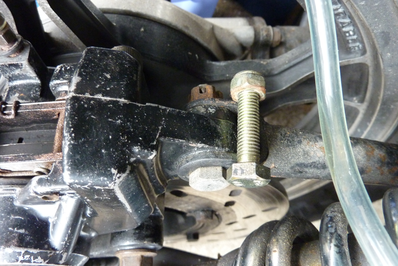

      Crap Torque Arm Bolt
      Need to be a little careful with this bike now. Obviously the PO was into short cuts. Why would you replace one of the most crucial bolts on the bike with a dime store look a like?
      This is what I found on the rear torque arm:
      I am not an engineer. But even I could guess that this bolt is going to be subject to a huge amount of shear when the brakes are fully applied.
      So let's get a proper one please:
