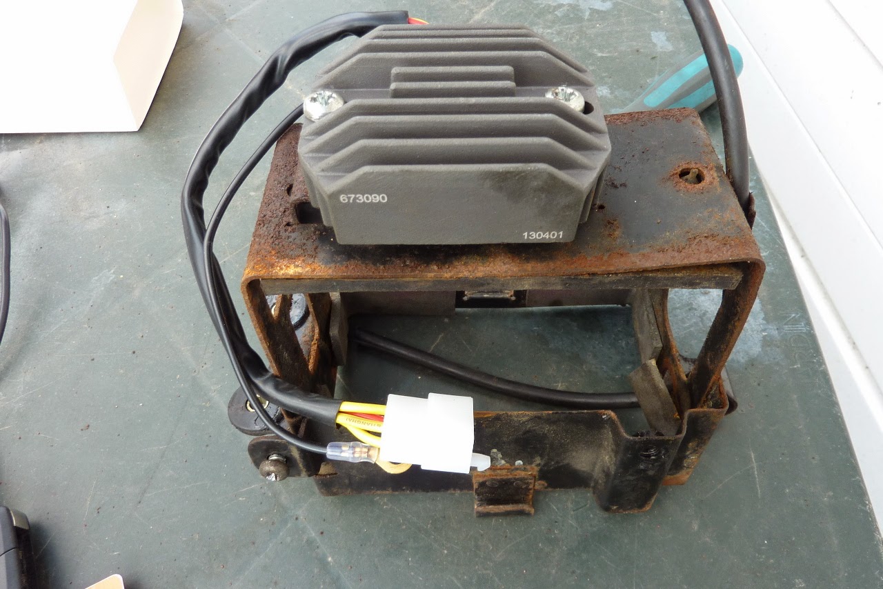

        New Rectifier Installed
        Got a new rectifier and tested it out as perfect. Put it on and tidied up some of the wiring including removing the stator headlamp loop and improving the grounding of the rectifier by wiring it directly to the battery (black lead only).
        See: My GS Road Runner Blog - New Rectifier
        And look, I do know what a nice battery box should look like. Don't have time to refurb this one. I just want to get back on the road. See:

          #94
          Ahhhh, so I guess that was your problem... good luck with the testing

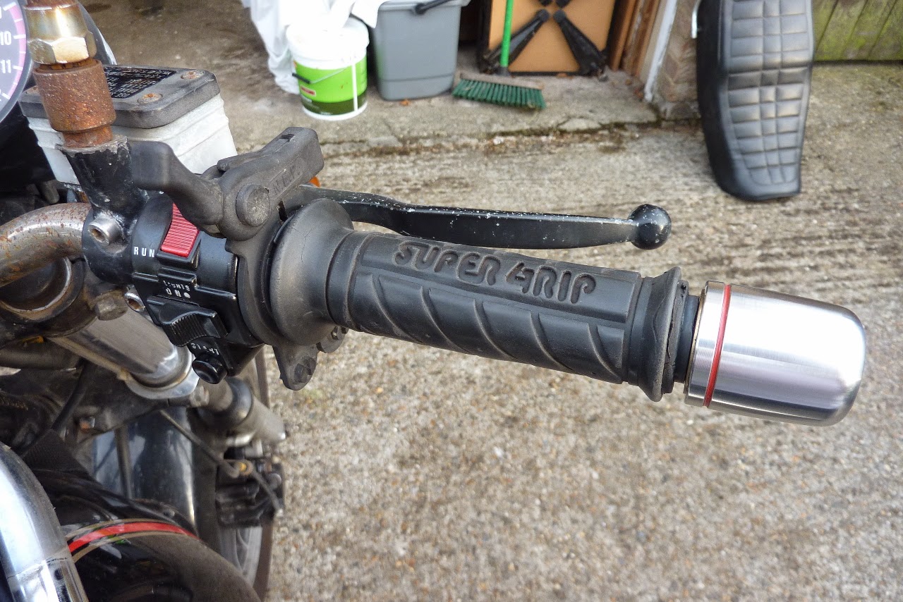

                                Getting Ready for a Long Distance Ride
                                I wanted the bike to be more comfortable for a long road trip to Italy. It has rather short bars on (which I prefer to the original cow horn type) but the feet forward pegs were not right for me. So I bought a set of Raask rear-sets.
                                See My Blog GS1100G - Long Distance Mods
                                Raask used to be top notch but quality is pretty poor now.
                                I also put on some handlebar end weights to reduce vibration. The bonus was that I discovered that I now also had a cruise control.
                                Next up will be a small screen.
                                Greetings
