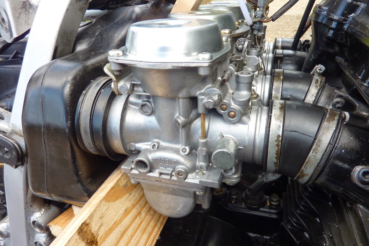

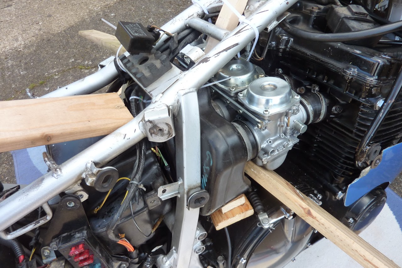

      The carbs were in place and the air box was ready. Now I just needed to push the carbs into the engine boots and get the air box boots on the carbs. Well the engine boots were pretty hard and the weather was cold. So even warming them up in the house had little effect. This was a tough job. Firstly I propped them up with some timber and strung them up with some cable ties. The idea being to align them to the engine boots so they could be pressed home.
      Some of the boots turned whilst being pushed against so there were frequent re-alignments:
      In order to get sufficient leverage, I resorted to my old trick of more timber.
      This bike will fly:
      Finally:
      It will be a royal PIA if it needs re-jetting after all this.

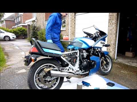

        Video of First Start Attempt
        Video says it all:
        What next?
        My checking so far has revealed only one cylinder is firing on full choke. There is fuel in the other cylinders. One spark plug (used on the plug lead of the firing cylinder) produces no spark.

                      Starts When It Has Fuel - What A Surprise
                      Spent hours over this thing. Checking all the sparks and whatnot. Rookie mistake: not enough fuel in the tank. Despite the float bowls showing me they had fuel in them.
                      Went and got some more fuel and she runs:
                      Not running nicely. Like the other bike that I did; very lumpy (needs carb sync) but also would not rev above about 4 - 5K. Just dies when you get it up there. That would suggest main jets. Now I did take that extra washer out from the needle that was below the little circlip. Has that done something?
                      After setting the idle speed it would hold a steady idle without any choke but would still not rev freely.
                      Anyway, I am dead chuffed I have got it spinning. Sounds like there is some cam chain lash so I will adjust the manual tensioner at some point if someone tells me how to do that.
