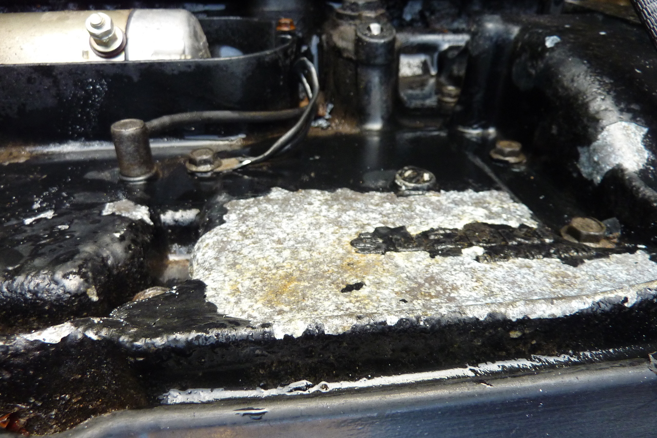

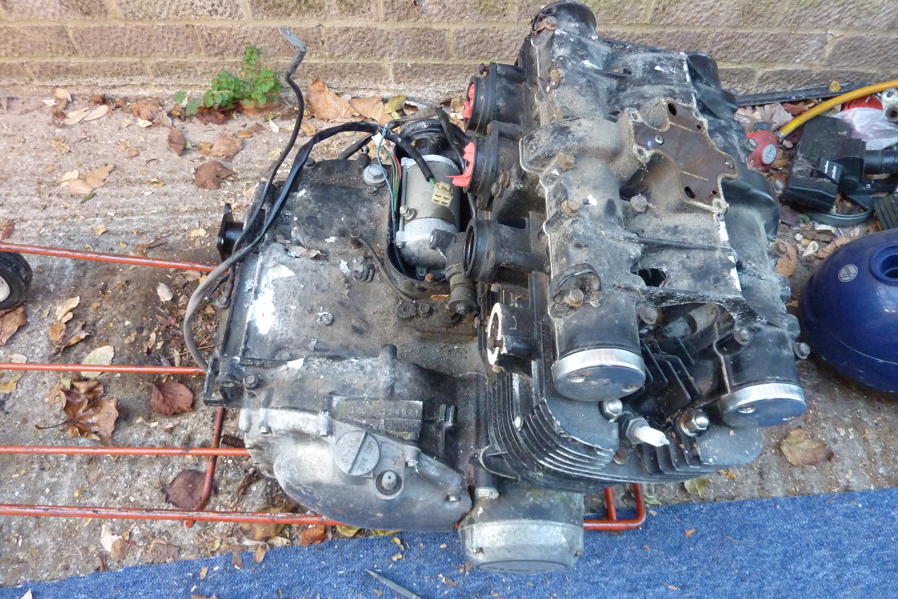

      I have a GS1100G which I have had from new and has only covered 19K klms. I know the motor is tip top and there is no need to rebuild but it looks like this:
      There is no point in disturbing the engine if it doesn't need disturbing. More likely that something will go wrong as you rebuild it (or after you rebuild it) and then you have messed up a good engine.
      I wanted to get my engine vapour blasted (which is a sensational finish as it is or if you want to paint it) but no one will take on a completel engine. It is too big and heavy for one thing and they say the fine media will ingress into the engine and damage it.
      Soda blasting is an option but I'm not sure it will remove old paint and oxidized aluminium.
      Hand preparation seems to be the only way to go on this one.
      Roll up your sleeves!!
