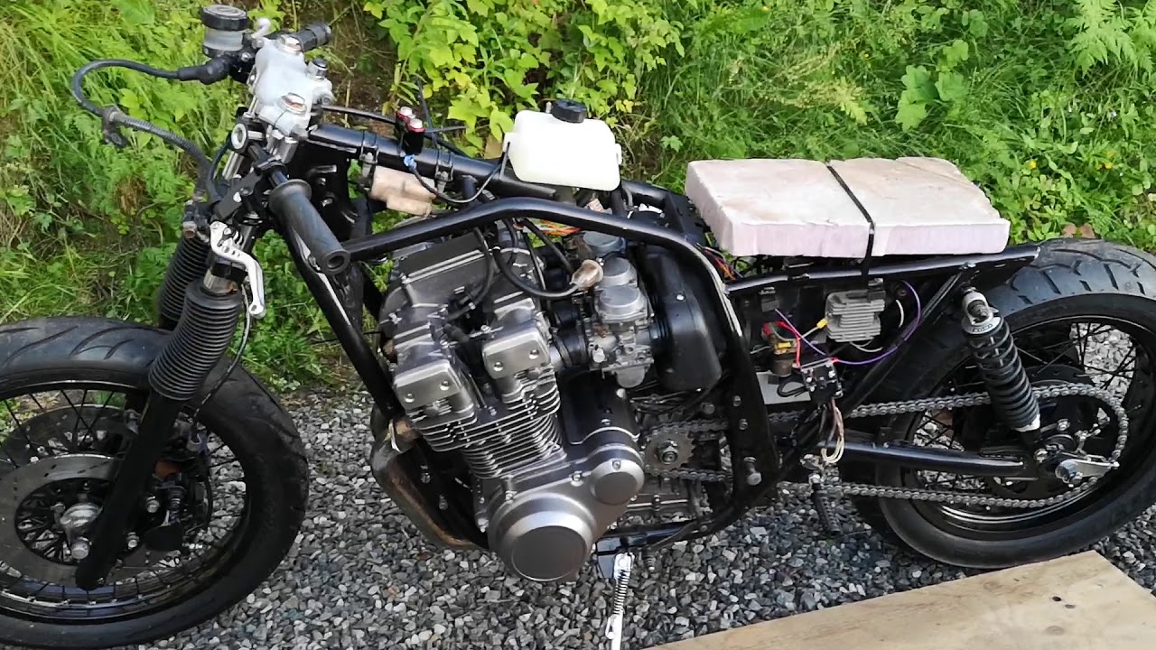

                              First test run on the road. Tank and seat are stowed away until all the wiring and cables are routed correctly. I'm quite happy with the seating position. Work done today is; 520 conversion, mounting brakes, throttle and clutch. Next time is carb tuning After that cable routing and finishing.
                                Btw, I have a Kerker 4-1 exhaust on. Anyone knows what kind of gaskets I need for this?
