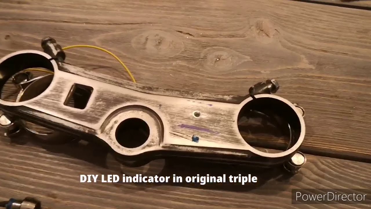

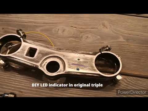

        Thought the Cognito Moto design of the indocator lights were much prettier than the big lights I used the last time. Drilled holes for 3mm 3V Leds, countersunk the holes 2mm and tested. Pretty satisfied. I did a test at a spot where I'm gonna remove material for the Mini anyway, just in case, but as I'm going with the design I'll position the holes below the Mini. Like in the picture I photoshopped. Here's a video I did to show the visibility of the LED (and some cheesy mobile editing )
