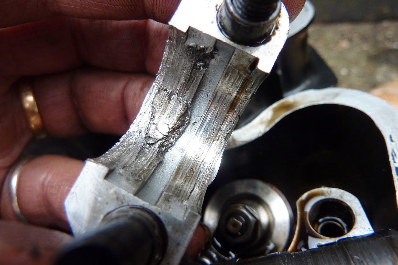

                      Perhaps more importantly than the lobes are the journals. Like Nessism says, wear on the lobes is perhaps not criticial unless you can see gouges and lumps of metal missing like this:
                      see how much of the lobe is missing on that!
                      More critical would be if you had any appreciable wear on the journals. This is the part of the cam that rests in the journals of the head and the cam caps. Measure at these points to see if they are in spec. Once those start to go out of spec they can wear quickly. See the ends of the cams in the above pic. Also inspect the head and the cam caps:
                      If you are worried I'm sure you can pick up a set of cams on eBay for not too many dollars.

                        Oh yikes - thankfully I've got nothing that looks like that, but I think those pics are more of a cautionary tale about what happens when you run it out of spec on those journal/camshaft/cap interfaces.
                        I'll have to look in the shop manual again, but I don't remember seeing a measurement method that didn't involve a "plastigage". A little reading has me less mystified by this tool than I was an hour ago, but is that the only correct way to check that? Is it the best way? Sounds like Plastigages are available enough, and the method's not difficult, just curious.
                        My parts look really good in comparison to these rough examples you guys have posted.
