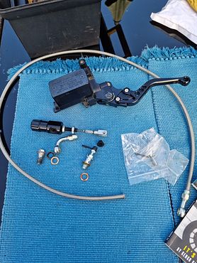

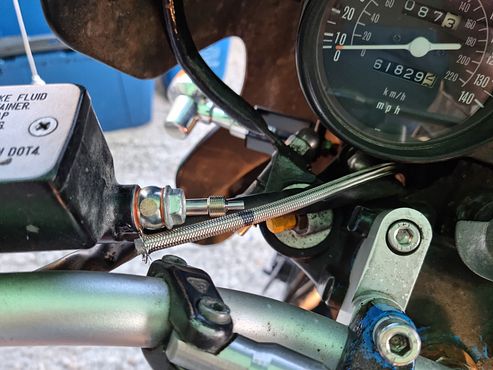

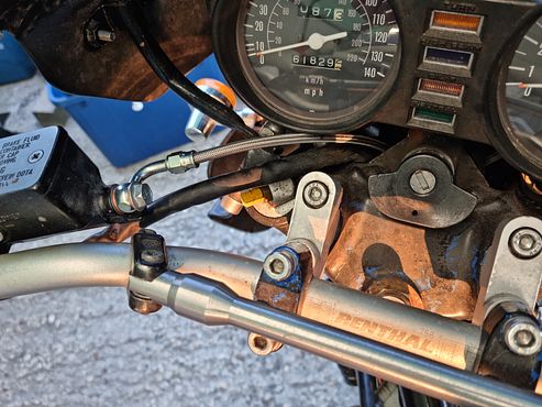

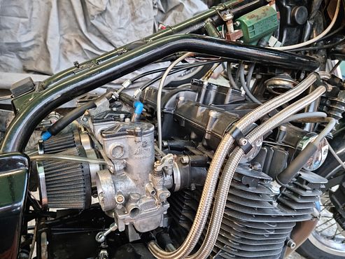

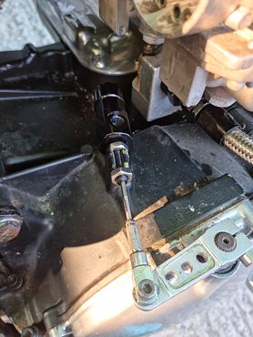

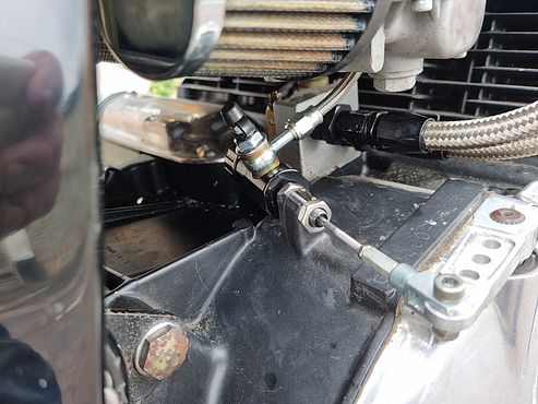

                Hydraulic Clutch Conversion
                There have been a few threads around the pros and cons to the hydraulic clutch conversion for the GS1000 and I have been mulling the idea over for a number of years and for no other reason than the fact I can I have done the conversion.
                Parts needed.
                I have used a GSF1200 Bandit master cylinder sourced 2nd hand from eBay ?20, 1m or 3'3" of Goodridge braided stainless PTFE hose with 1 M10 90deg 3/8 banjo ad 1 straight extended neck M10 3/8 banjo ?35.95, 1 Chinese slave cylinder with rod ?17.99 and 1 clevis fork end 5mm ?2.99. The whole lot was ?76.93 or $105.
                I realise that a new cable is considerably less but I was collecting the parts over time and I was not worried about the cost.

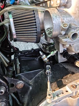

                Next I offered up the slave cylinder to make sure it was lining up ok and did not foul the carbs.
                Then I added the hose with the banjo fitted to get the best angle for the blead nipple and plan the route for the pipe between carbs 3 & 4.

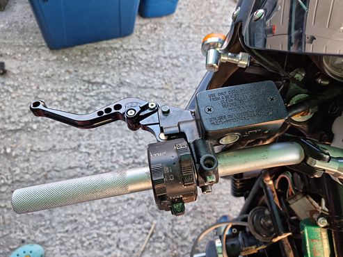

                Next the master cylinder was fitted
                Then the hose was run up to the master cylinder
                The hose was offered up to the 90 deg banjo on the master cylinder and marked for cutting to length, I could have left the extra on the hose but it would not be right.
                Then the hose was fitted and tightened up
                This is a short vid of the conversion in action after bleeding which only took 10 minutes.
                https://youtu.be/USBIIe2pVsc
                I was really pleased with the final fitment and the force to operate the clutch is slightly lighter compared with the OE cable, probably not a conversion to replace the cable for a big reduction in leaver force but for a because you can conversion it is worth it in my opinion.

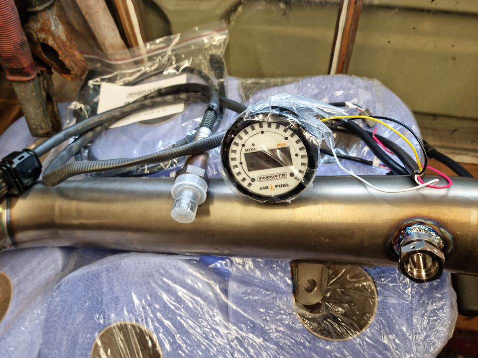

                        Update time.

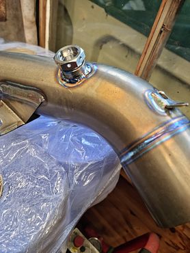

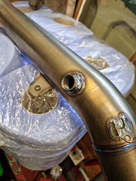

                        One of the biggest challenges with our bikes after the motor has been modified is making sure the air fuel ratio (AFR) is correct. One option and possibly the most popular is dyno time which no matter which country you are in is expensive so I am looking at an alternative for my bike.
                        I have bought an Innovate MTX-L Plus wide band AFR gauge with a Bosch LSU 4.9 wideband lambda sensor. I have also had a grown up weld a TI lambda boss into the TI exhaust.
                        I have tuned fuel injection engines using WB lambda sensors and tuning carbs will be fun. I can data log the sensor and the main difference is I will be riding the bike instead of sitting on a dyno, I will see how that goes.

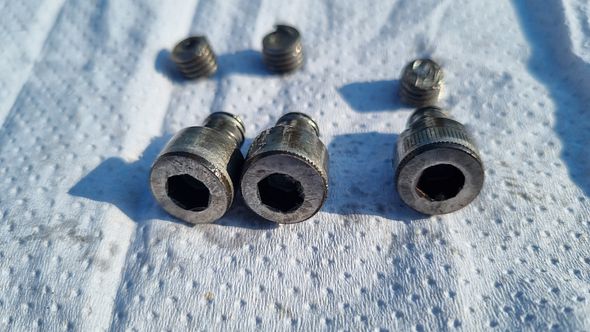

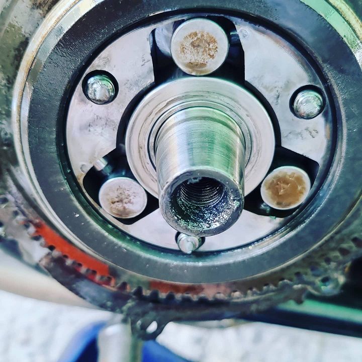

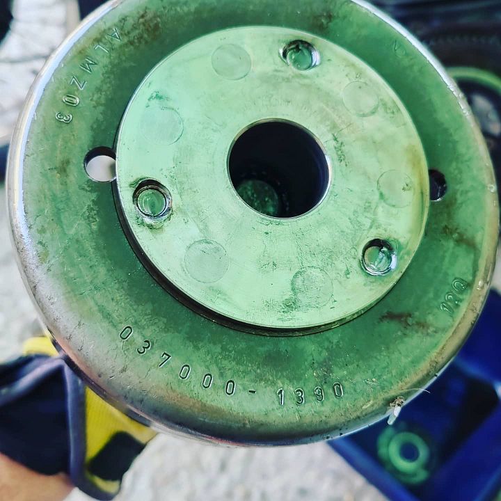

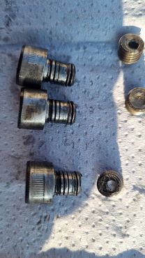

                          One of the benefits of owning and maintaining our old bikes is you tend to know all the little noises the engine makes. On idle there has been a ticking noise that had started to get louder, not to the point it was a loud metallic noise but enough to hear it with my helmet on, raise the revs off idle and the noise went.
                          We all know that ticking noises are notoriously difficult to pin the location down and I thought it was a shim. The cam cover was removed, clearances checked and found to be spot on.. I started to think I had an internal problem until I went to fire the old girl up and it just spun up and rattled. I removed the stator cover and found...
                          I managed to get the broken ends of the bolts out and you can see the cause of the ticking noise was the loose cap heads rattling around in the starter ring., luckily there was no damage and the small amount of filings were on the magnets for the stator.

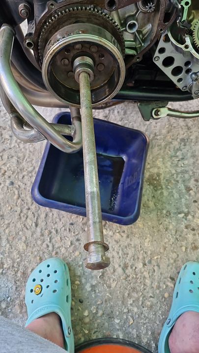

                          A top tip for removal of the rotor assembly, you can use the swing arm pivot bolt instead of trying to find a puller that will never fit properly. As you tighten the bolt tap the free end with a hammer and it will pop off without damage and no use of Anglo Saxon words, and yes they are safety crocs.

                            • 7611
                            #73
                            Yep, you're not the first to see this problem. Maybe the 3rd most common GS problem behind the charging system and clutch... Loc-tite and a little extra torque and hope for the best.
