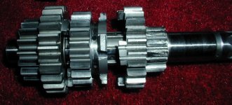

Right is a stock welded up basket, center has an aftermarket thicker backing plate and 1100 SC gear, left is billet with thicker backing plate and 1100 gear. Left is what you want.
Ward pickup may work for your dyno only pulls. It would not work for me. Note the teeth.
If you use a stock transmission, with the billet parts, you may want to consider removing the stock bearings too.
