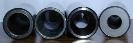

Left to right, stock, Wiseco, MTC tools steel, APE tool steel. The MTC pins looked real good. I ended up using the APE parts and never switched them.
