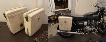

Long pause on the updates, but there has been progress! Started taking the side bags apart. They are full of cracks and scratches. Both sides have one of the aluminium bands broken etc. They are assembled with aluminium rivets, so it was a job of drilling the rivet heads off and punching the rest off.
Fixed the cracks with glass fiber and ground down the bits where there was a misalignment between the bag halves. It was my first try on glass fiber fixing but it came out ok.
Cut a piece off an aluminium sheet and made replacements for the broken bands on both bags. Cleaned and polished the old and new bands to make them match.
The bags hang on rubber bushing which were in a very bad condition and not optimally shaped in my opinion. I designed new bushings on SolidWorks and also designed molds for casting new ones. My friend printed the molds for me and cast samples out of mold silicone. The material is quite soft, I'll have to find something less soft sometime, but these will do for now.
Did some eBay shopping: Stainless steel truss-head screws with phillips head (to match the screws on the engine), suitably sized latch locks, Suzuki badges. Then took the rear cowl from the bike to a paint shop for mixing me some paint. Painted and assembled everything. The painting went horribly wrong, but at least now I'm not so stressed over any scratches or dents they will get ;)

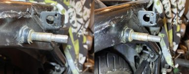

Mounted the bags on the bike with the self-made mounting rack. Finally! This has been the biggest job on it so far and came out fine. It's not perfect but at least I will not see another bike on the road with a setup like this :D
