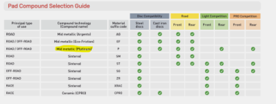

Hi Brian,
This cut and paste, or similar, is widely shared on the internet in regards to Ferodo Platinum pads
Ferodo Platinum Front Brake Pads
Ferodo Platinum Organic Brake Pads feature a proprietary carbon grip compound that utilizes the same technology pioneered in Ferodo's extensive world racing program. When developing the Platinum compound, great care was taken to minimize rotor wear and to ensure performance remains consistent through the life of the pad. Organic pads are often selected thanks to their excellent modulation characteristics and will often run quieter than their sintered counterparts. Features:
  • High friction level offered in an organic compound
  • Excellent modulation characteristics
  • Low disc wear when compared to sintered compounds
  • Consistent performance throughout the life of the pad
  • Suitable for use on ABS equipped motorcycles
Edit: is from Ferodo's motorcycle website. They denote the Platinum compound "mid metallic". I should imagine, they may wear the rotors more than a pure organic compound. They are not classified as sintered, though.

Thanks for the correction, Ed!
I do know that the Ferodo platinums I tried worked fantabulously well, but they did indeed cause visible rotor wear on my GS850G. So it makes sense that they're somewhere in the middle and not fully sintered.
You can find leftover stock of the Ferodo FDB218 (cross-reference to EBC's FA51 designation used on my GS and many other 1980+ models) here and there, but it's not clear whether they're still making them. Or maybe the supply trickling in from Italy is just that small and sporadic.
From info I can find, Ferodo discontinued the pure organic compound. Within their part numbering system, the "Material Suffix Code" is at the end of the standard size part number. So, FDB218P, would be the Platinum version of that pad you found. A quick check on ebay shows that the organic pads are hard to find. For that matter, the Platinum compound can also be.
