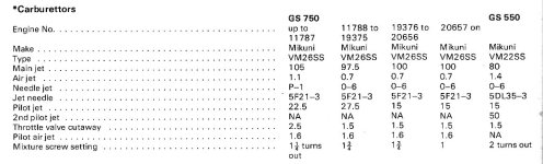

What were the factory size main jets for the vm26 carbs? Mine appear to be 112.5.
Say i wanted to run some k&n pods, would a bigger jet and needle height change be necessary? The clip on the needles are in the middle slot.
Bump............
standard mains are 95. if you want to run pods and you have a 4 into 1 exhaust then go for a Dynojet stage 3 kit.
