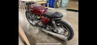

I'm curious how your going to keep the tire from hitting the cross bar? It looks pretty close ;)
Its definitely a concern lol. I was bouncing around with all my weight and a buddy of mine said it wasn’t close to hitting but worst comes to worse, I’ll put some taller shocks on it.
B1E88464-3849-4D9D-98F2-34917EE6C614.jpgGot my new rubber on the rear wheel. Went with a Shinko tour master. Was able to mount it easily by using some big zip ties to squeeze both tire beads together as I maneuvered it over the wheel.
Also there were comments about my tire being close to the frame, which I totally agree with, so I ended up putting the stock shocks back on which raised me back up about an inch. Here’s how it sits today.
6781C249-6EAB-4436-A363-89E2EBA2CF34.jpg - Click image for larger version  Name:	6781C249-6EAB-4436-A363-89E2EBA2CF34.jpg Views:	0 Size:	63.9 KB ID:	1694472
