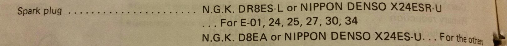

I'm too lazy to look up the information specific to the 1985 750, but typically the spark plug caps have a 5k resistor, and because of that you should not use resistor spark plugs. Those DR plugs you bought are resistor type.
Here is a snapshot from my manual. I have no idea what electrical type number (E something) my bike has.
Let's go by the book ...
If the decision between DR8ES-L or D8EA is determined by the cap (having or not having the 5K resistor) than I can buy a combination of D8EA + The 5K resistor cap, right ?

In the USA the bikes used resistor caps and non resistor plugs. I don't know about Israel though.
