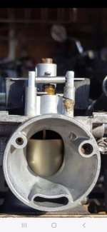

Has anyone successfully used JB Weld to reattach a float pin mount? A previous owner broke one and used some kind of silicone to put it back on.

No, but I've seen one successfully TIG welded back on.
I've done it by drilling it & inserting a brass rod up the middle of the post & then into the body. Wasn't easy but it seemed to work.
I’m giving it a shot. Worst case it doesn’t hold and the float gets lopsided. Then I’ll look into finding another carb.
JB Weld won't hold. And that YouTube dude is a dud. He didn't even ungang the carbs to clean them properly.
Get a new carb body.
That float post on my carb was like that when I got the bike, so I'm really not sure what kind of adhesive was used.
Maybe as a test you can stick some scrap aluminum together and let it marinate in gas for a while, then try to pull it apart.
There are various tests on the internet already, including Youtube, and the JB Weld didn't hold. Yours may have something inside, like a peg. Not sure.
When I did it I put a peg inside vertically and then cross drilled it and inserted horizontal and snipped it close.
as I said it wasn’t easy but it did work.
all in it’s easier probably to get a new carb body….
