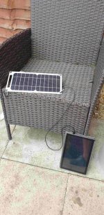

Solar panel arrived.
Oddly cloudy here in UK, Somerset ! almost looks like rain to come !
Anyway 10?, small flexible panel that will fit in any pack , and a single usb-a outlet.
Says its a 6w, 5v output.
- Test at 5.36v on my east facing window in the afternoon on a dull day.
(I had to strip the wire on a usb cable to get down to two wires to test )
The bottom line is outside on a day as described above it immediately starts to charge the power pack or phone. So for emergency use it ticks the box already for long remote rides on a old bike !!!!!

I can tell the interest in this post .... so I must continue .
Now as I can't know what amps are coming out of the solar device in different sun strengths until I get my meter all I have is this .
Analysis:
mobile phone
from 11% to 17% took 30mins.
in good sun
it did state that it was not fast charging.
But for an emergency and for day charging up / topping up usb devices it seems to be ideal. The bike does the fast charging on the move.

The one I bought 10? can go in any day bag, is flexible and raises a mobile phone 7% in English semi sunny day in 30mins. It works on speaker too and all other usb devices.
My mobile battery is 3000ma and my power pack is 10,000 ma. LED lights I have , some can be done quickly.
There is a app called 'ampere' that hells you the amps on phone being charged from.any outlet.
I got 50-400ma on a dullish occasionally sunny day.
3000/400 = 7.5 hours from flat to fully charged .
(yes it is not 100% efficient )
For emergency use it is ideal. I saw 800ma in full sun but need to test this more as I'm in England !!!!!!

Test 1: 100m trip to fairford airshow.
Madly sunny - midday sun.
I got to say my 10? 5v (supposedly 6w) solar panel is ideal for the roaming traveller with no room.
​​​​On a sunny day I get about 400ma charge.
This is enough to charge phone , keep in charge when not riding. Can also charge all other bits like - led torches, spare phone , power pack (slowly)
This with the backuo bike usb charger connected to battery pretty safe and content !
