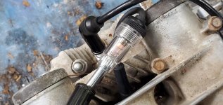

Ok. I also went and got a spark plug tester.

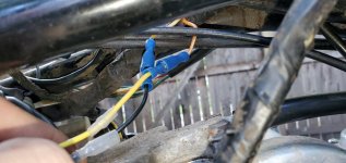

The issue is that spark is getting to coil 1, but doesn't seem to go through it to the spark plug. I tried connecting the loose wires with spade connectors, but I still got no spark. Back when they were bullet connectors, they got some spark, intermittently. Coil 2 still uses bullet connectors, and gets spark.

I laid the spark plug directly on the block, even held it against it. Still nothing. I bought some bullet connectors, I'm going to try them tomorrow. The wiring was exposed, and exposed wiring acts like an open circuit.

I hooked up Coil 2's bullet connectors (which were the original ones that came on the coils) to the wires that go from the harness to Coil 1. No spark.
It may be the connection between them. Coil 1 doesn't have the original bullet connectors anymore, neither does the wiring harness. They don't seem to like anything except the original bullet connectors. Modern bullet connectors, spade connectors, nothing seems to work.
