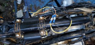

There was a time I disconnected and reconnected the connectors for Coil 1, and it sparked. I think the problem is right here: 15678146453001857095962092747742.jpg

Non-insulated bald crimp connectors laying on the frame ?
What could be going wrong here ..?
I hope those are not touching the frame nor each other when you are trying to diagnose the issues.
Or am I just seeing that wrong.
I've actually had them up off the frame while starting, as I didn't want them to ground out.
What color wire do you have going to the black wire of the coil in the foreword wiring bundle? It is hard to see in your picture.
The white wire.
I got it to spark, I bound the connectors with tape. However, still won't start.
If you have to tape those terminals, they have to go, they won't last. This site sells the right terminals and crimping tools for your bike. (http://www.cycleterminal.com/bullet-terminals.html). If you need to have more than one wire to go to different places, solder and heat shrink them. Just one wire per terminal unless they are designed for it. Spark is one part of the equation along with compression and fuel. It will start if it has all three.
