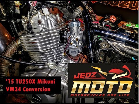

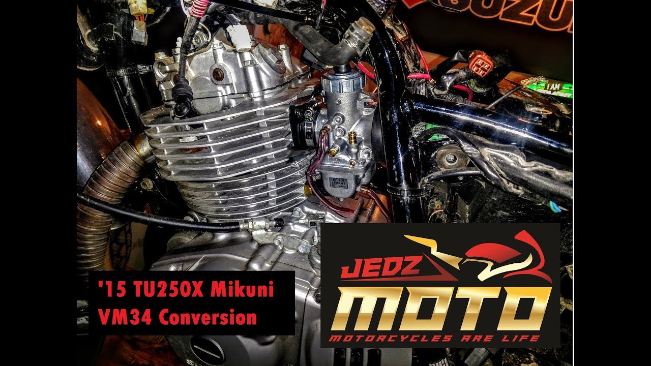

                            Made the TU250X a heavy(errr) breather.
