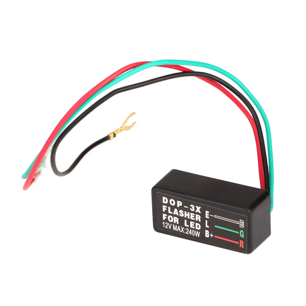

                Today I fitted an LED flasher unit, as the original 'zuk one finally stopped working properly, refusing to flash on the right side, oddly enough. I put that down to difference in connection quality somewhere on either side. Since I was changing the fronts to LEDs, it needed a new flasher anyway.
