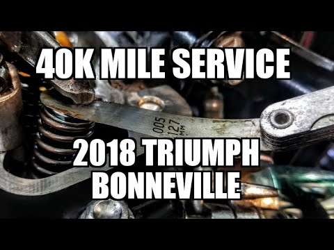

                      Did my 40K mile service on my Bonnie... Here is how I checked the valves!

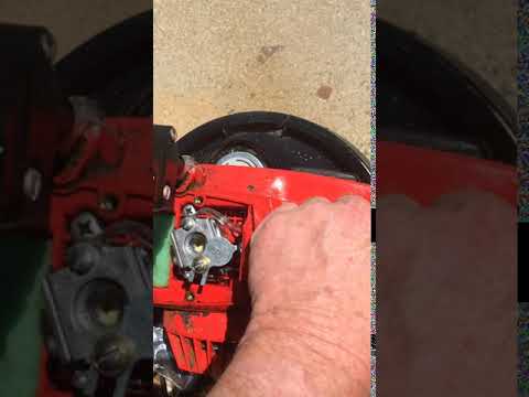

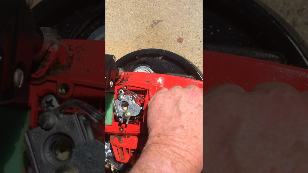

                              1979 chainsaw running again
                              How this for a 1979 chainsaw, after not running for a couple year?
                              Craftsman (Poulan)
                              Had not run in a couple years.
                              Found fuel line (from carb, into/thru handle, and then another into the main body into the tank, to a filter) hard and cracked, and broke as soon as touched it. Went to a couple hardware stores and didnt find any similar size gas line. Went to a small engine repair place and did find some replacement line.
                              And got it running
                              Hows this???
                              Note: 1979, 16:1 oil mix (8 oz per gallon)
                              Another story about this saw: About 10-11 years ago, I had not used it for 5-6 years, and could not get it going. Took it to a local repair shop, they said cylinder was scored and not worth repairing. I was annoyed, compression felt okay to me thru the sparkplug hole. I fussed with it some more. Took it to a friend who said we should inspect the carb diaphrams. We took it apart and he said they were fine, all the little flaps were there and not wore off like can happen.
                              I posted here on GSR (2007? 2008?) with pics of the diaphrams, and a couple guys also said they were okay as long as the little flaps are intact, and the gasket edge is okay. Then along comes Ben 2BRacing, and says the diaphrams need to be replaced because they have a slight warp to them, they did do not lay completely flat. Said that Warbo carb is the same model as carbs in his go carts (although his much bigger). SO I get a replacement set of diaphragms, and verp-verp-verrrrwhaaaaaaaaaa.
                              I was so impressed.
                              Impressed with Ben.
                              Impressed with GSR.

                                How this for a 1979 chainsaw, after not running for a couple year? ?????..Another story about this saw: About 10-11 years ago, I had not used it for 5-6 years, and could not get it going. Took it to a local repair shop, they said cylinder was scored and not worth repairing. I was annoyed, compression felt okay to me thru the sparkplug hole. I fussed with it some more. Took it to a friend who said we should inspect the carb diaphrams. We took it apart and he said they were fine, all the little flaps were there and not wore off like can happen.
                                I posted here on GSR (2007? 2008?) with pics of the diaphrams, and a couple guys also said they were okay as long as the little flaps are intact, and the gasket edge is okay. Then along comes Ben 2BRacing, and says the diaphrams need to be replaced because they have a slight warp to them, they did do not lay completely flat. Said that Walbro carb is the same model as carbs in his go carts (although his much bigger). SO I get a replacement set of diaphragms, and verp-verp-verrrrwhaaaaaaaaaa.
                                I was so impressed.
                                Impressed with Ben.
                                Impressed with GSR.
                                Thanks Dave! Yes, I remember that very well! Must have been some of my earliest posts on GSR around January 2009!
                                Here is a photo where my son (#6) is struggling to stay ahead of the previous year's champion (#1) and nearly getting it crossed up into the corner!
                                The Walbro carb (very common on small 2-stroke engines) has 2 mixture adjustment needles (for low and high speed). On the 100cc engine in the go-kart the carb sits behind the driver and quite low down, so my son had to find the high speed needle "by feel" to adjust it when the engine started to get hot near the end of the races.
                                I strapped an old carb to a belt and made him wear it around the house, and practice to put his hand down and back to find the needle and tweak it slightly to make the mixture richer! I replaced the diaphragms after every race in order to ensure maximum performance, and we came second in the championship that year by 2 points, so I knew my way around those Walbro carbs!
                                Very glad to hear that your chain saw is running again Dave!
