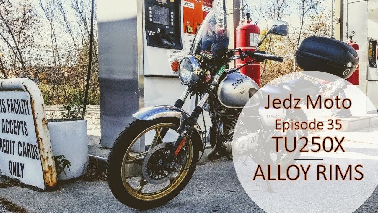

                    Converted the TUX over to Suzuki Alloy Snowflakes from some of my GS parts bikes.
