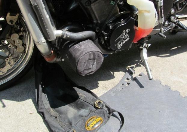

      Hey Bill, unfortunate about the low side. Off camber so hard parts were closer to the pavement .
      Did anything touch to cause the low side? Just curious
