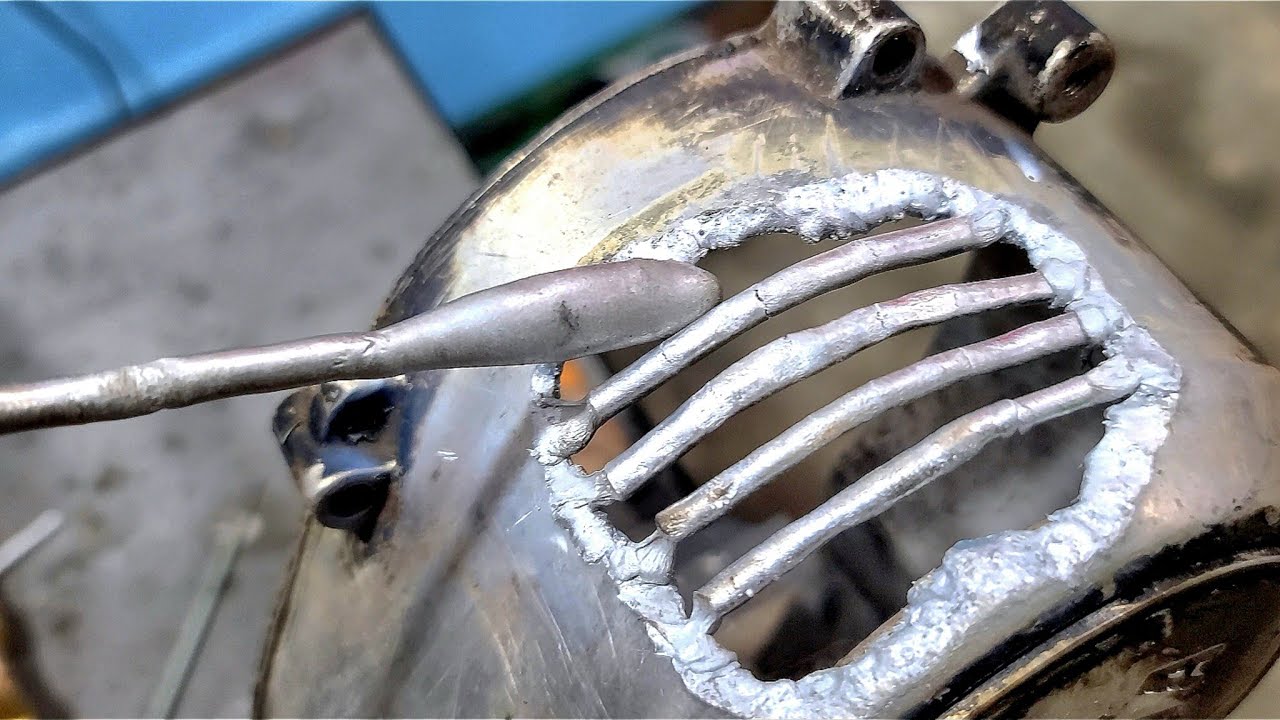

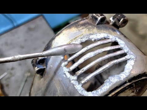

                                #8055
                                I know next to nothing about welding or brazing of any kind, but this video popped up a few weeks ago. I didn’t know this was possible.
