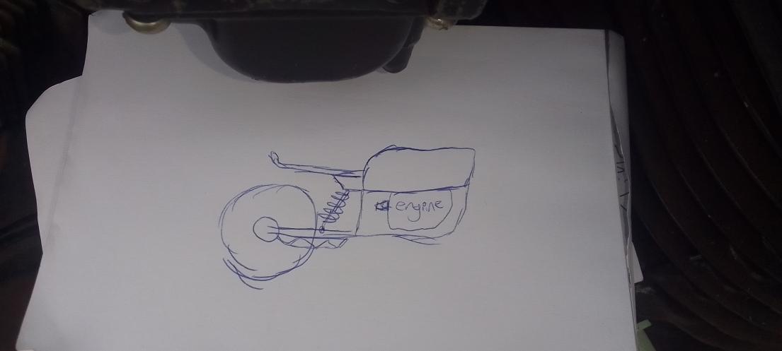

        I will now be building my seat around the batery, id prefer a flat seat with a tiny lift at the back, if i mount the batery in the back it will be a bit to high for what im going for. Mounting the batery above the shock seems like my best bet at the moment.
          IMG_20230202_174243.jpg That seat frame there was jusy to test the shock its getting taken off, after that the batery will fit alot better.
            IMG_20230202_173858.jpgsomething like that then the rest of my electronics further along the seat.
              IMG_20230203_103219.jpg not the best drawing but itas the concept
                IMG_20230203_103211~2.jpg so ill build a little box around the batery and have a flatish seat coming from there.

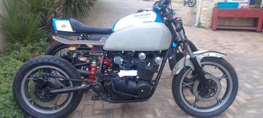

                        Project has been put on hold till end the month, I bought over one of my friends 1979 750. So i just need to top up the savings first before i continue. IMG-20230210-WA0015.jpg
                          Plans for this month will be to open up the motor making sure everything is in good shape and looking for any parts i need to replace. Im almost done with the subframe design. Still making small adjustments to make sure theres enough space for all the electronics and at the same time make it as small and strong as possible. Ill updates with more photos as i get the small things done.
