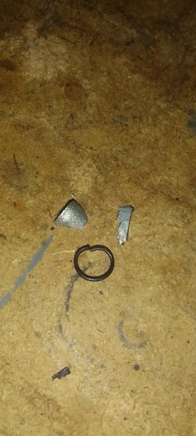

                              So i finally got a quick moment to split the carbs and get the seal out This is what poped out on the other side the leaking side didnt have anything left. So when it comes to a replacement part. Do i get a o-ring or wont that work.
                                #45
                                Will that o ring go over this item or inside the carb. I havent opened the other side IMG_20230316_182953.jpg
