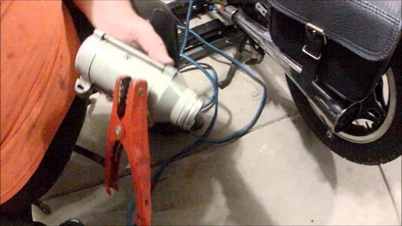

                        Quick starter question
                        20170614_084724.jpg If I test from this terminal to the case should i see continuity?
                          • 35927
                          Yes, you will probably see continuity. That lead is for the power that will spin the starter. It goes from there, through one brush, through the windings on the armature, through another brush and on to the case, which is grounded to complete the circuit.
                          Not sure what resistance value you should see, but it should be a bit above zero.
                            Thank you Steve, I see zero resistance.

                              The GL1100 starter was a known weak spot.
                              There is a thread discussing how to rebuild them on Goldwing Docs forum
                              Here -->>
                              http://goldwingdocs.com/forum/viewtopic.php?f=11&t=259
