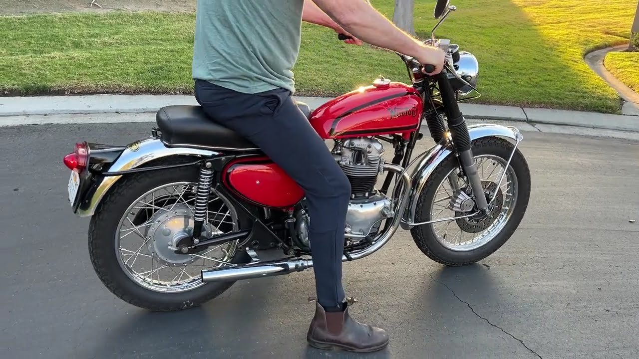

      Back to bike news, it's idling well now that the engine's broken in a bit. I've still got a slight stumble at small mid-throttle openings to figure out. If I gas it, it's fine. It idles and has great power, and sounds sweet. I swapped fork oil for heavier grade and that made a big difference. It's super good, and the disc is really strong. I can chirp the front any time. It starts first or 2nd kick when cold with the Mikuni enrichener lever pushed down, then I ride it away and flip the lever up, and it's a one-kick start. It sounds great and handles well. It doesn't even leak any fluids. I am waiting for the other shoe to drop... I can't be this good of a builder, can I?

                            What about a 'start up' vid? Your son films you approaching the Norton cold (hand on exhaust header), then you slowly explain each step in getting it running.
                            I may be wrong, but I'm under the impression it's a little more involved than turning the key and pushing the button like on our UJMs.
                            • oldGSfan
                              • Jul 2018
                              • 1324
                              • Southern California
                              #119
                              Here you go Rob. I appreciate your interest in the bike.

                                So the 'enricher' is equivalent to a choke?
