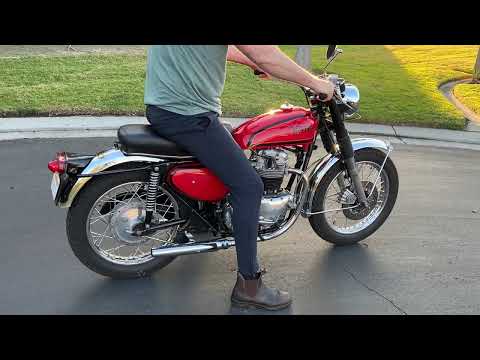

My Norton is taking shape
    Wow...very impressive! Sounds great.

      The N15 will have a temporary roommate on Sunday. Bit of a sad story...
      A guy I met at a show in November passed away. We exchanged a few emails and then he went quiet. His wife contacted me using his Email (I met her at the show too). She needs to sell his '71 Commando to help with funeral expenses. I offered to help clean it up, give it a service, and market it.
      It runs, has a new seat, and looks good, but has been sitting outside under cover for a while.​
