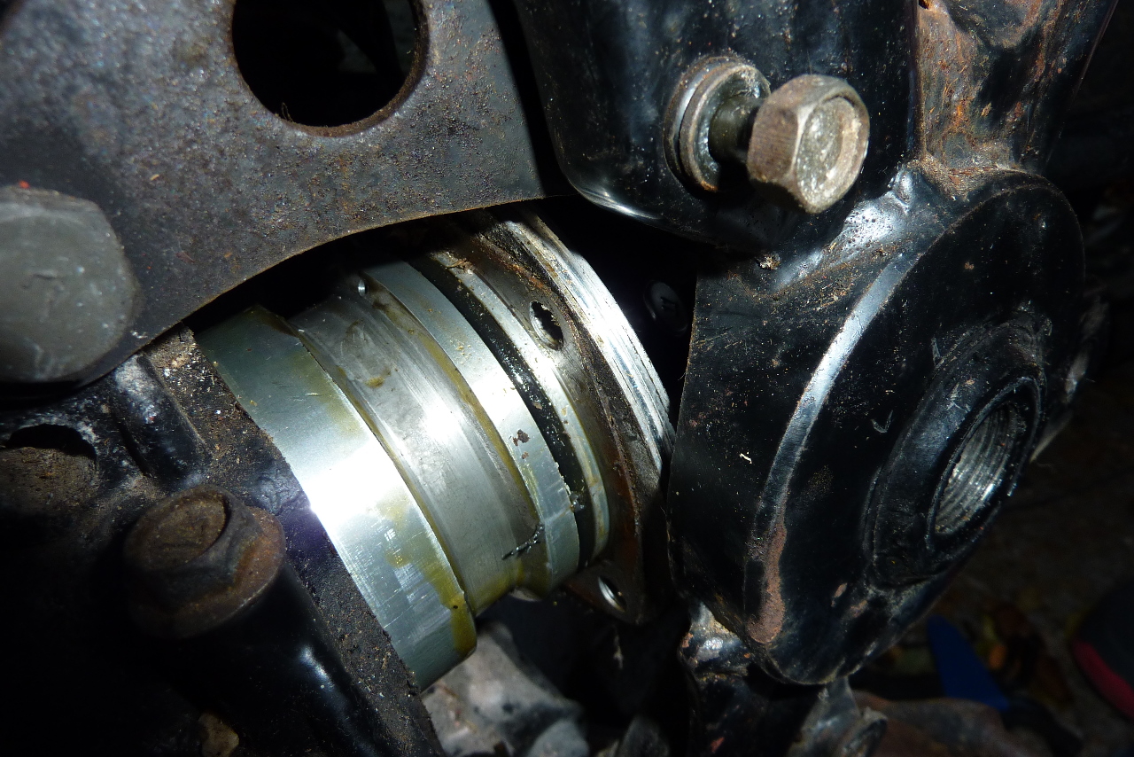

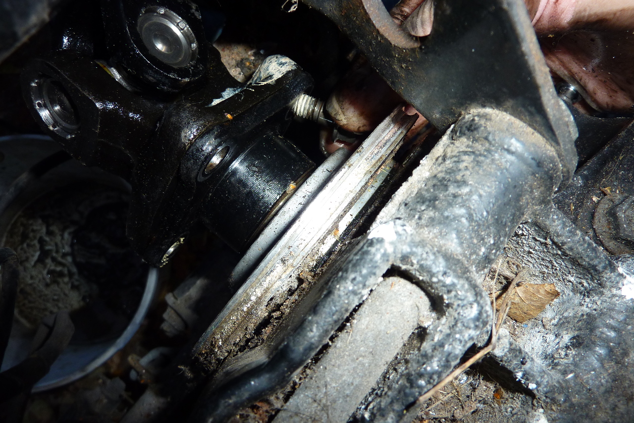

                  I didn't know about the splined shaft at the wheel end. I imagined it to be another screw type affair (thanks bwringer). What I was trying to do (in my mind and in reality) was to break the link between the engine and the shaft drive at the universal joint near the engine end of the shaft by undoing the gold bolts (or at least darker bots) that join the shaft to the universal joint. The bolts point (by this I mean the head faces the engine and the threaded end points to the rear wheel) to the back of the bike and can be seen here (the one that the screwdriver head is touching):
                  My idea was to remove these bolts and then the shaft would be disconected and the engine could be removed. The problem is that without removing the rear swing arm (I didn't want to remove it as I wanted to wheel the bike to the garden to do the engine removal on it side "trick") it is very difficult to get to these bolts and remove them. Well I found it impossible.

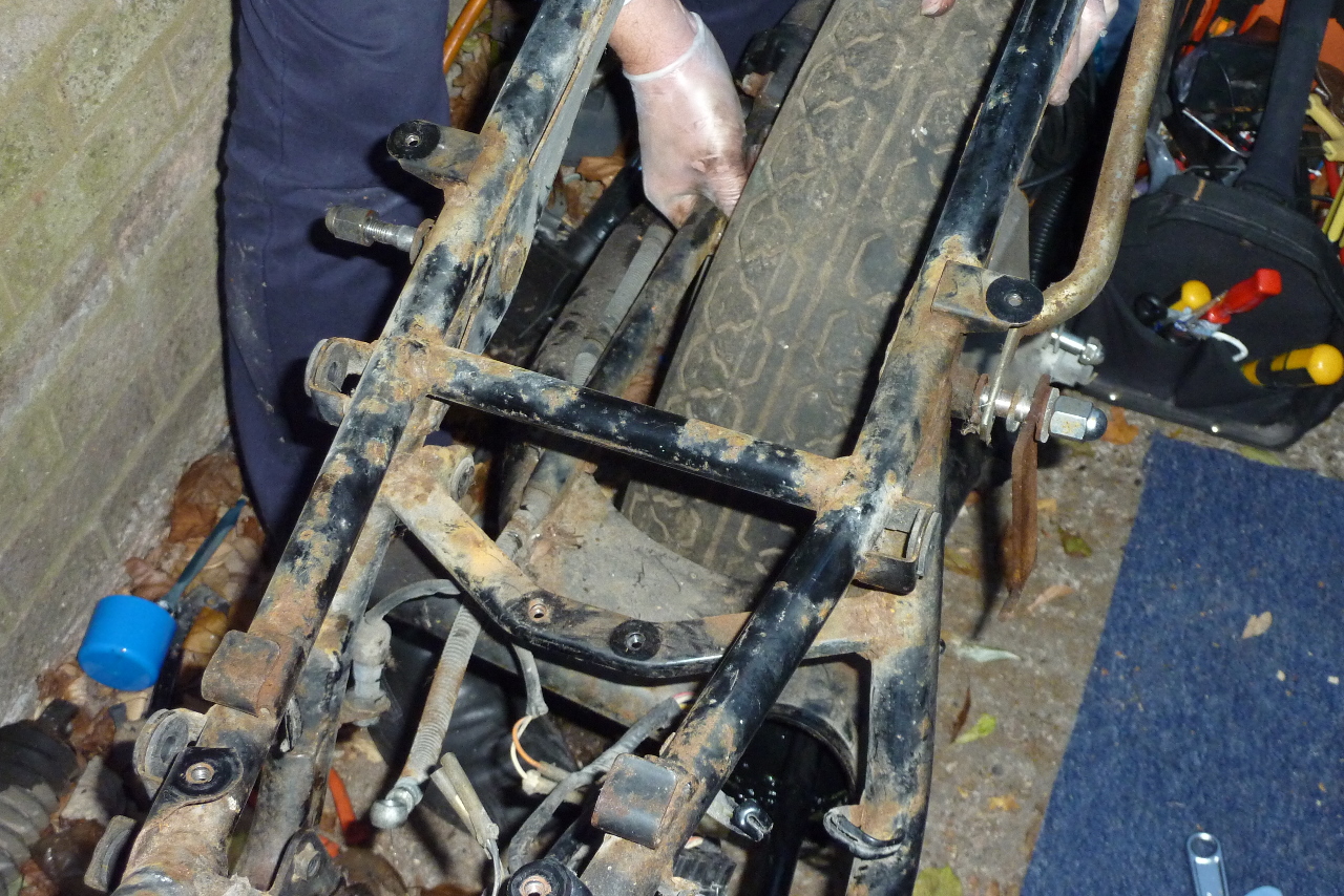

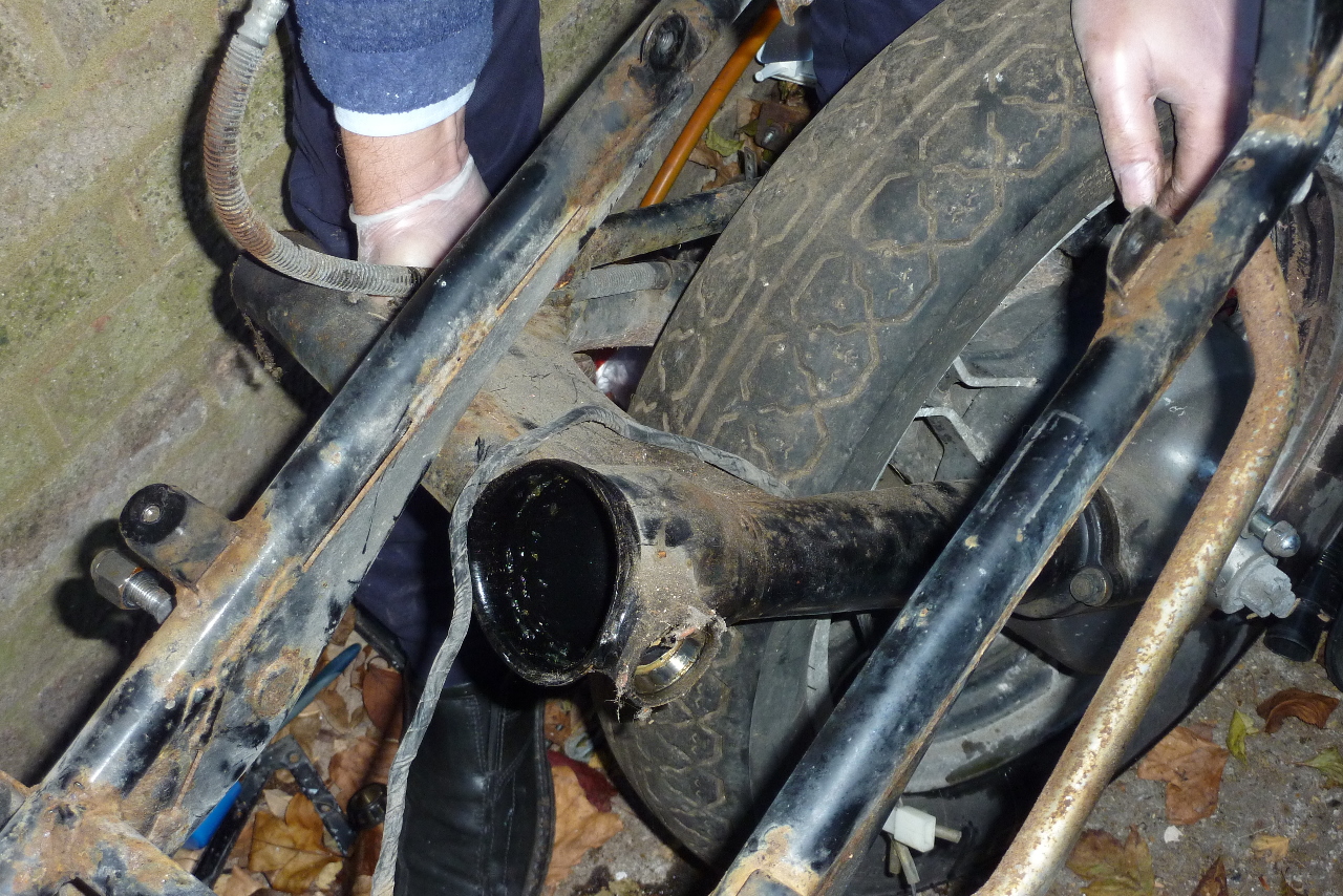

                  There were problems so I removed the swing arm to get better access:

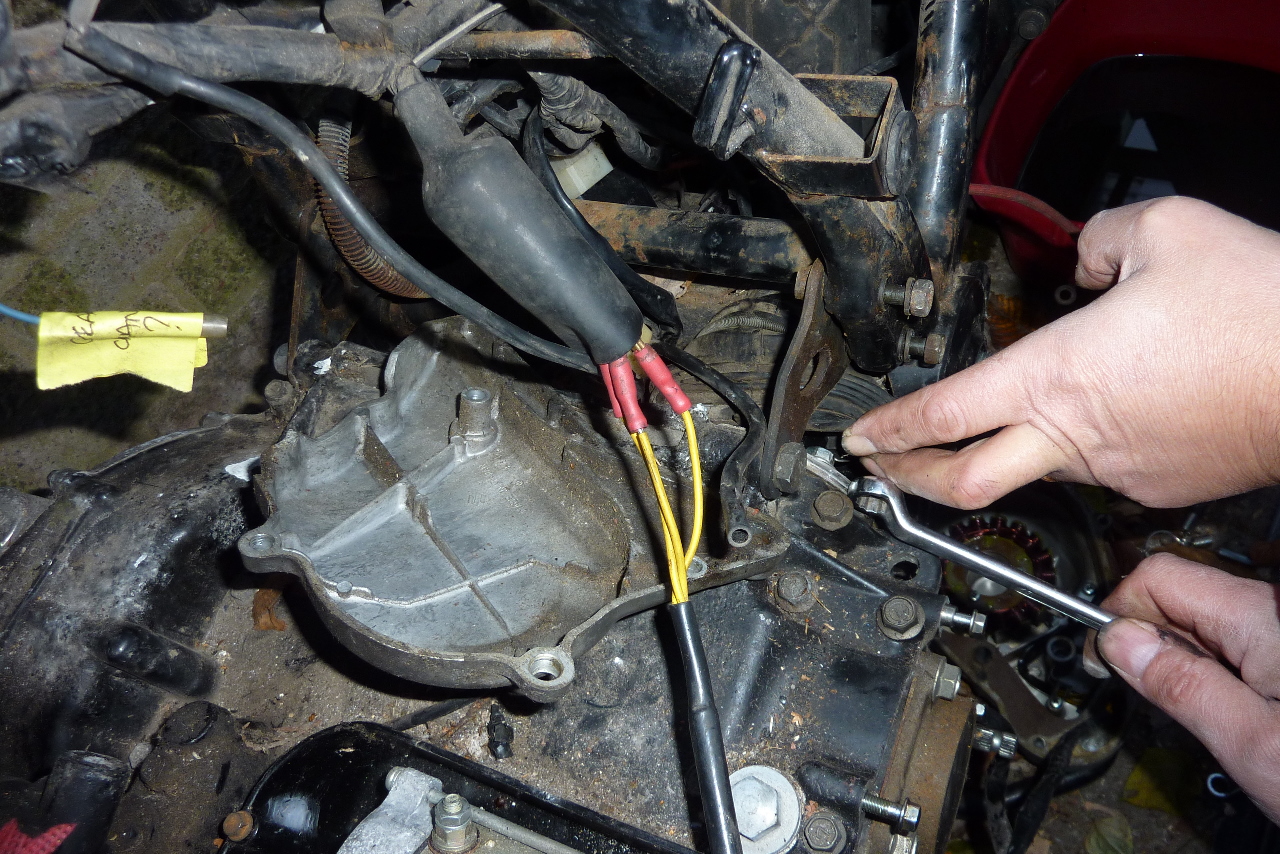

                  Now to get the shaft off. I started on the bolts that go into the engine casing:
                  This would allow me to get the shaft off surely (and quit calling me Shirley) but I didn't know it was the helical gear housing and not the shaft connector.

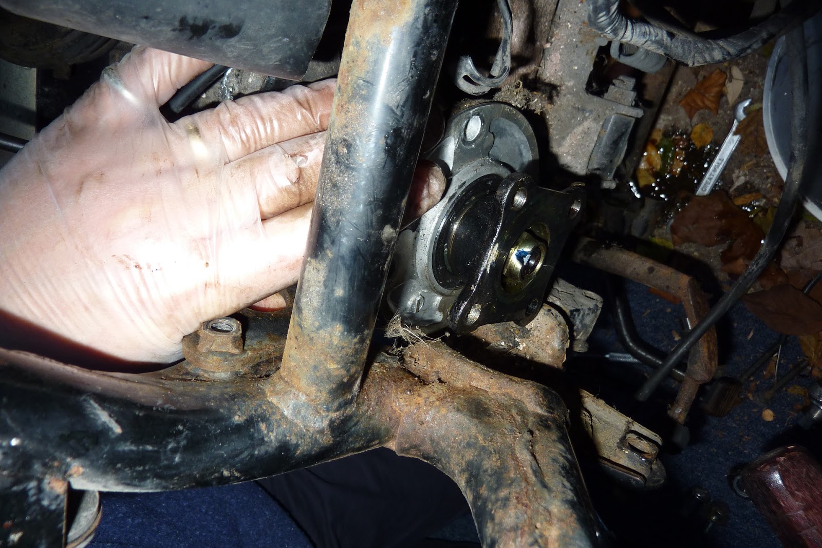

                  And that it would not come out completely as it hits the frame here:

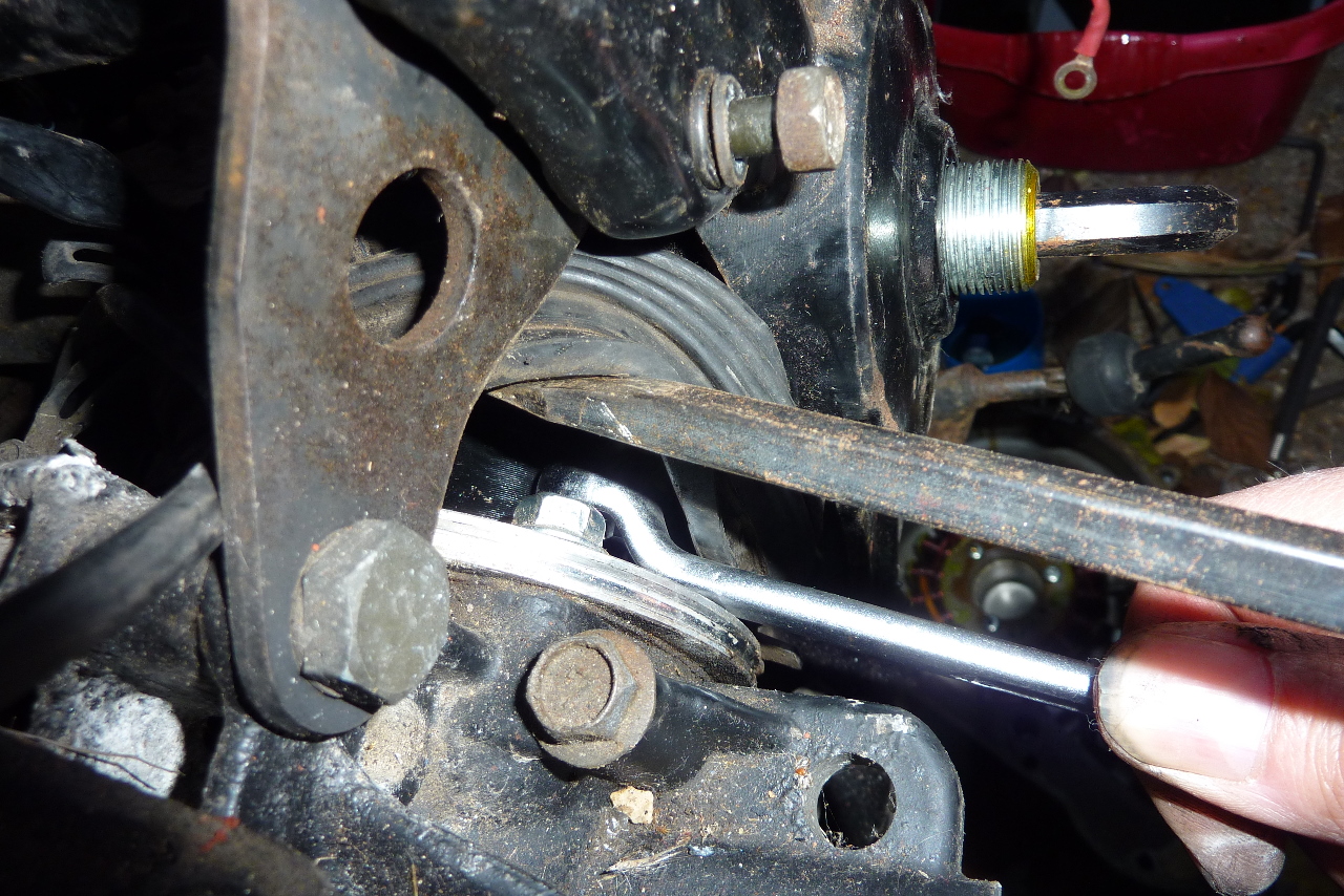

                  So it was back to the idea of trying to get the shaft disconnected. But the shaft kept turning when you applied any pressure on the spanner. I had to use another spanner and lay it against the tops of 2 of the bolts and jam it against the frame in order to get any leverage. I did it in the end.
                  You can see the other spanner at the bottom of the picture. I didn't actually work like this but I did not get a photo of the actual arrangement I used.

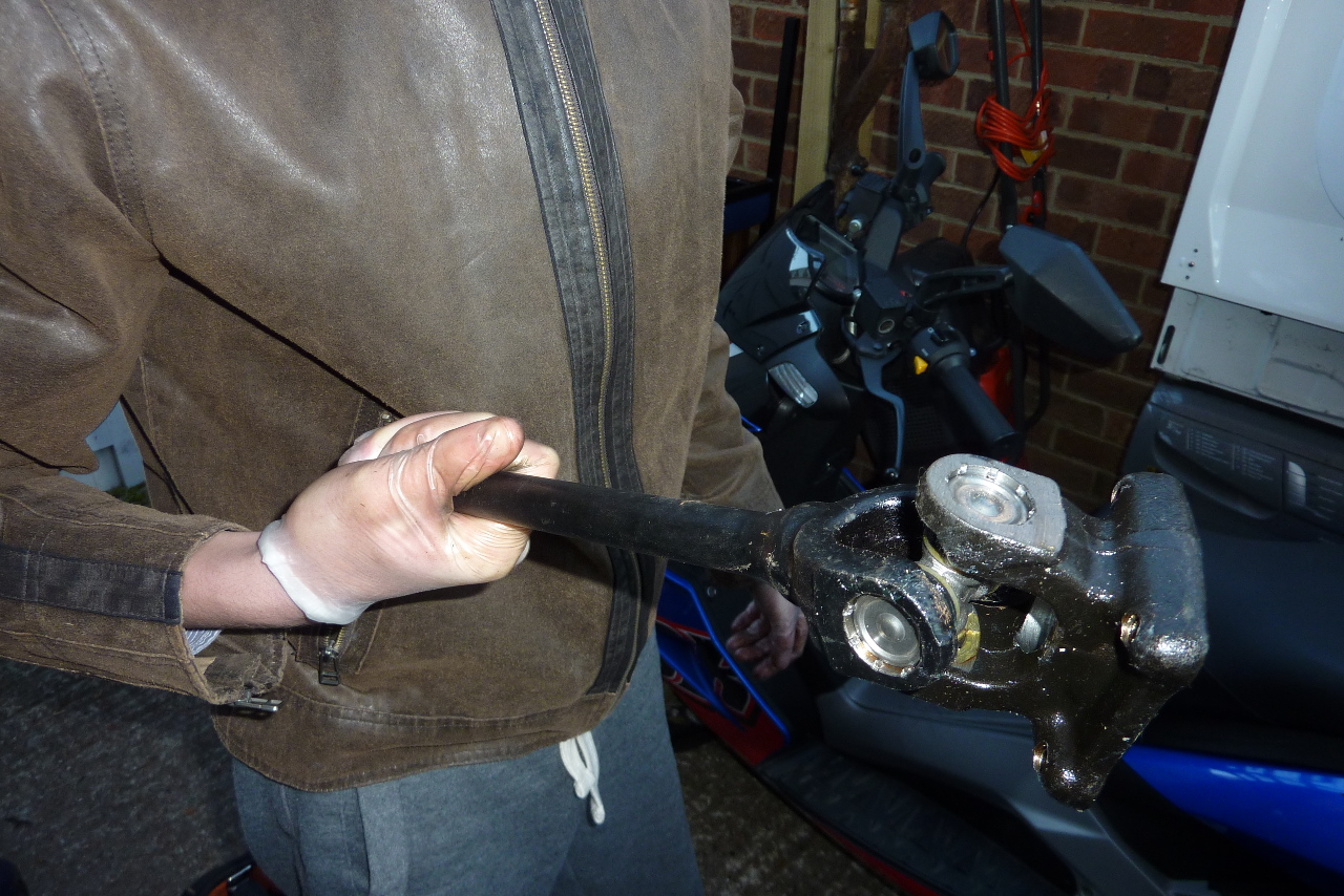

                  That's how I got the shaft off. Now to get the engine out.
