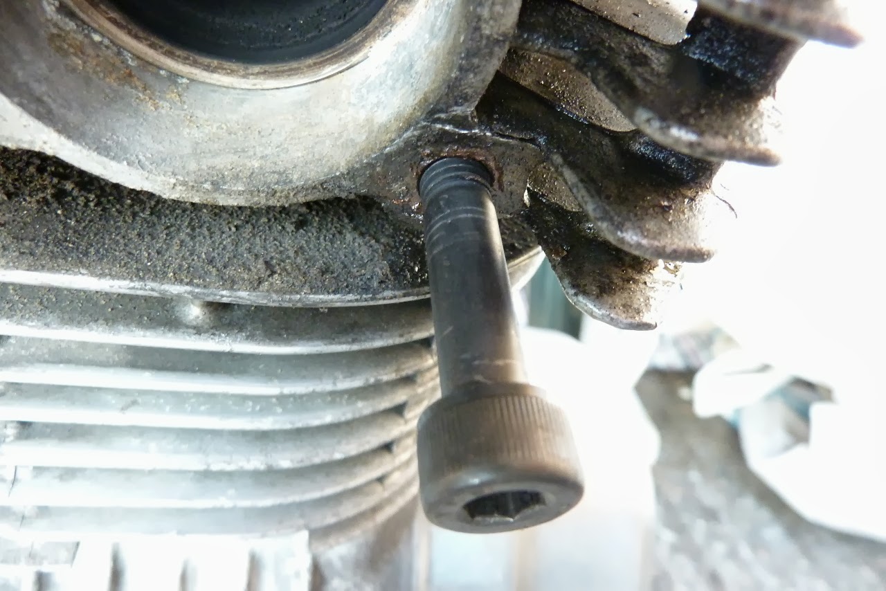

    I'm working on my GS1100 Road Runner Project and I now have a dilemma with my exhaust bolt holes. They (when measured with a caliper spike) are all the same depth but on some I can turn a bolt in 6 times only and on others 14 times.

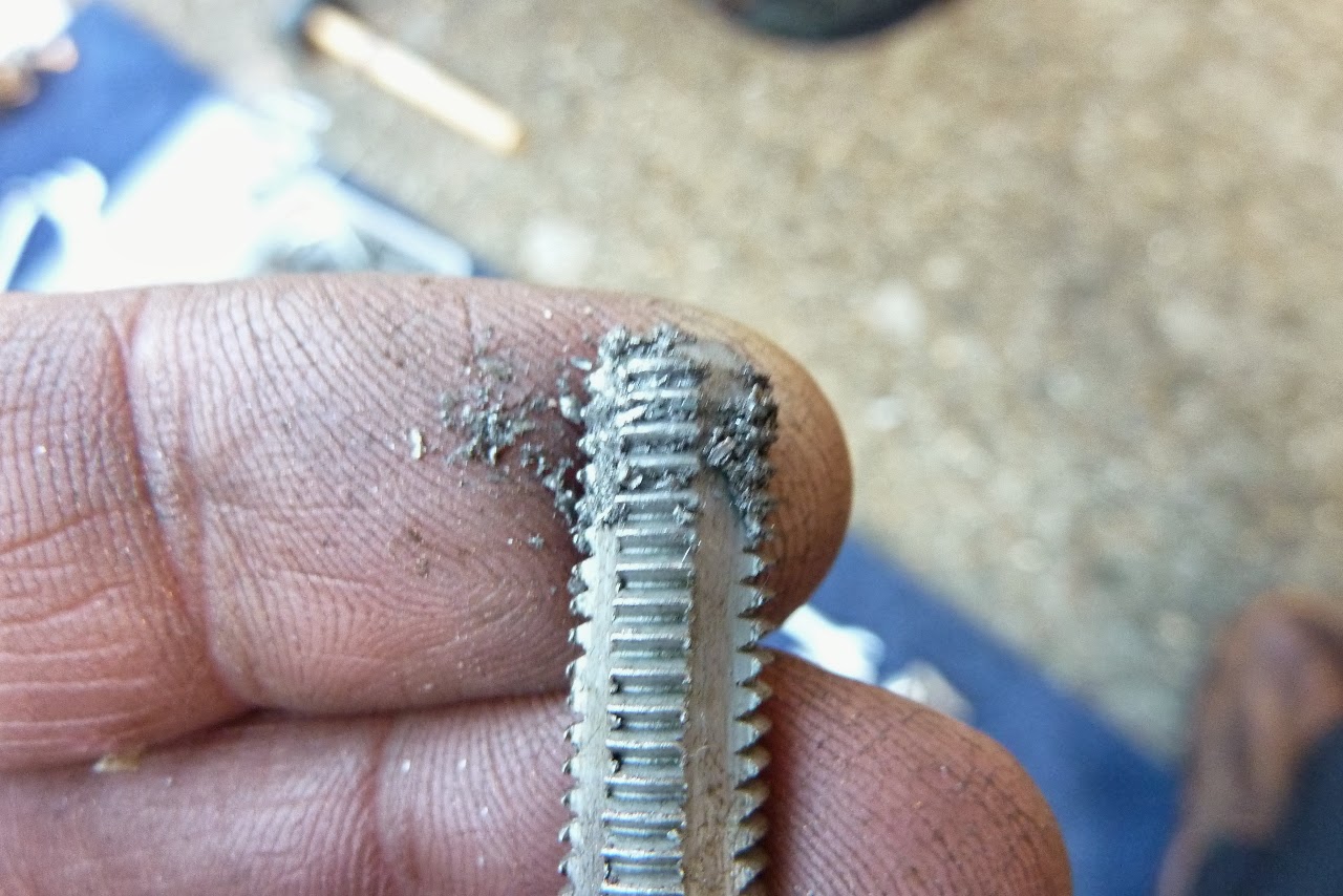

    So I thought I should try a little tapping and all this stuff came out after about 4 or 5 turns:

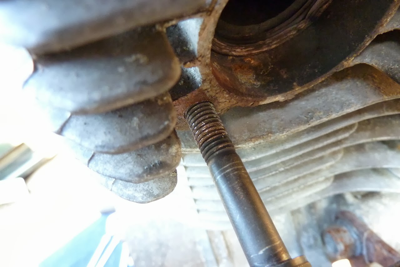

    The bolt does fit in the tapped hole nicely now (up to the 4 or 5 turns) but should I continue tapping down? I am afraid I might be doing irreparable damage. Seems like there is a lot of metal coming out.
    Or is there a tap that is different from the M8 x 1.25 that I am using that should be used just to clean up the hole?

          The threads are deep into those holes, but the bolt doesn't go full depth. Cleaning them with a tap is the right approach, just make sure you have the proper tap. I believe you need 8mm x 1.25, but please measure to be sure.
          EDIT: post above showed up while typing.
          The crud is corrosion deep into the hole. The bolt only uses the first few threads, not full length, so crud build up at the bottom. Make sure you use anti-seize on the bolts and go easy when tightening the bolts to avoid stripping.

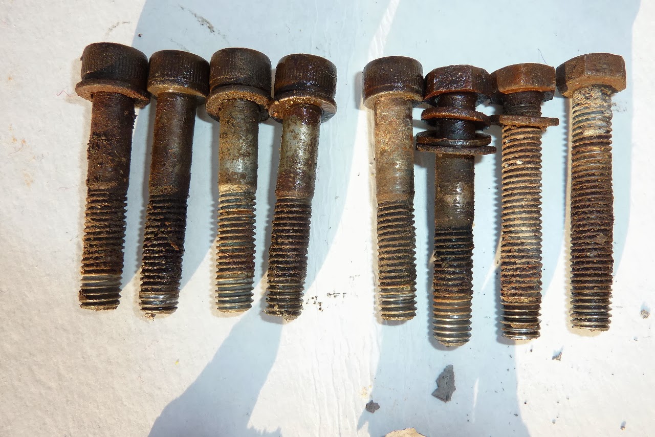

            You can see in this pic of the bolts used by the PO (all different sizes and with various numbers of washers) that some of the bolts were only biting by a couple of threads (see 2nd bolt from left). I have bought longer bolts. Originals were 45 mm long and I have some 50s and 55s. I would like to get a bit more bite.

              Arent stock ones something like 35MM from shoulder to the end? To keep them from bottoming and punching into the head itself??? And yes on flooding the hole with a spray bottle full of water or something to rinse the chips and crud out and lots and lots of air to blow as much out as you can get out.

                  Which was the reason I posted about what the stock bolt length was. Remember some time ago someone posted they drilled and then had oil running out one or two of the bolts holes.
                  Had a 750 with a bad crank so it became a parts bike. When I took the pipes off oil came out of the bolt hole on cylinder 4 I believe it was. Anyhow, when I measured the bolt it was 40MM from shoulder to the tip and it was an allen head like he shows in his pictures. So I assume the head has been punched and its no good.

                      Installing a Helicoil or Timesert isnt an issue as long as he does NOT go deeper than what the depth measures with the probe. In fact, I would stay 3 MM minimum short of the stock depth just to insure I didn't punch thru anything.
                        best bet with all suzukis that use bolts to hold the headers is change them to studs & use spring washers & brass nuts instead, i,ve changed them on all 3 of my engines, after problems like yours. you need to clean up & make good the threads you've got left, tap them a bit deeper if required, then thread lock some good hi-tensile stud material in, or a cut down full thread set screw to required length.don't use cheap general threaded bar ! brass nuts can undo themselves so leave enough length for 2 nuts locked together.

                          Suzuki lists the correct length bolt as 35mm but if you have the newer aluminum collars they are thicker than the older steel ones.
                          I ordered Suzuki OEM bolts and they didn't even reach the threads.
                          My finned collars are 26mm thick plus the 3-4 mm space as they do not tighten flush against the head, plus the washers, that leaves only a few thread in the head if that.
                          I needed to use minimum 45mm bolts to get a decent bite, can't remember if I used 45's or 50's but 55 is too long.
                          Check the thickness of your finned collars, then measure the depth of your holes and use a bolt that fits but doesn't bottom out.
                          Re-taping the hole is fine, your taps look like they are taking out a little material, because you're using a but as long as the bolt is still firm and not loose in there then no worries.
                          Just found this, the article recommends that when tapping into aluminum you should have threads 1.5-2 times the depth of the bolt diameter, so that would be 12-16mm of threads.
