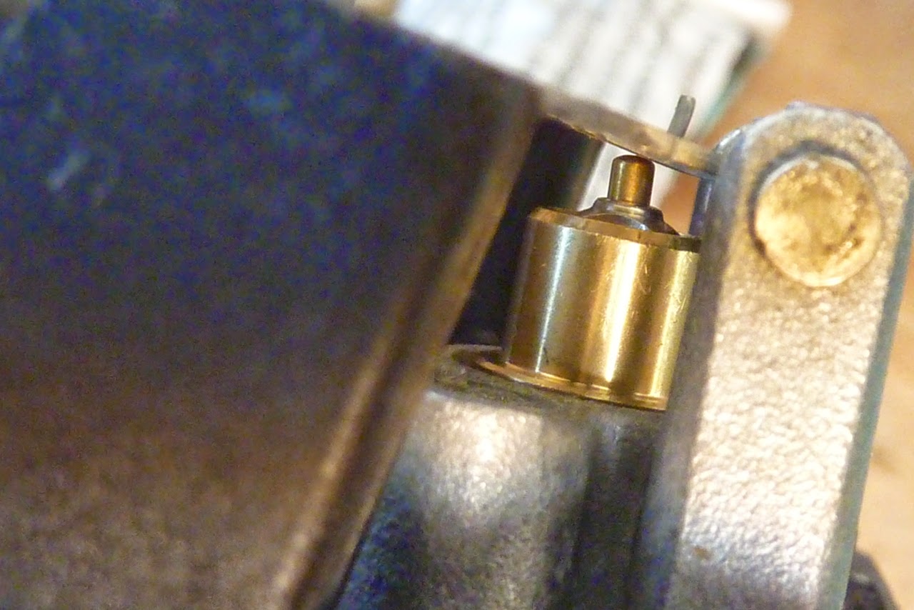

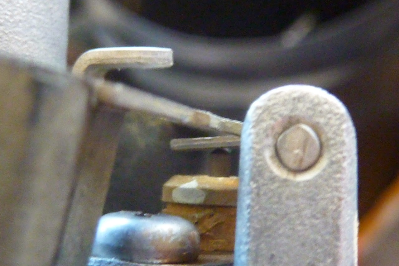

                              Bent tangs and needle valves
                              I had this issue on my GS1150ES. I had bent the tangs too far but only because the needle valves and the little spring in the needle valve were knackered and it was necessary to bend them that far to obtain the correct float height reading. But clearly it was a bend too far:
                              I replaced the needle valves completely (don't tell Steve that I used K&L carb kits though) and you can see the difference.
                              Now the tangs are at a more acceptable angle. And the bike works.
                              I also had rebuilt the main jet needles incorrectly. Check them too.
