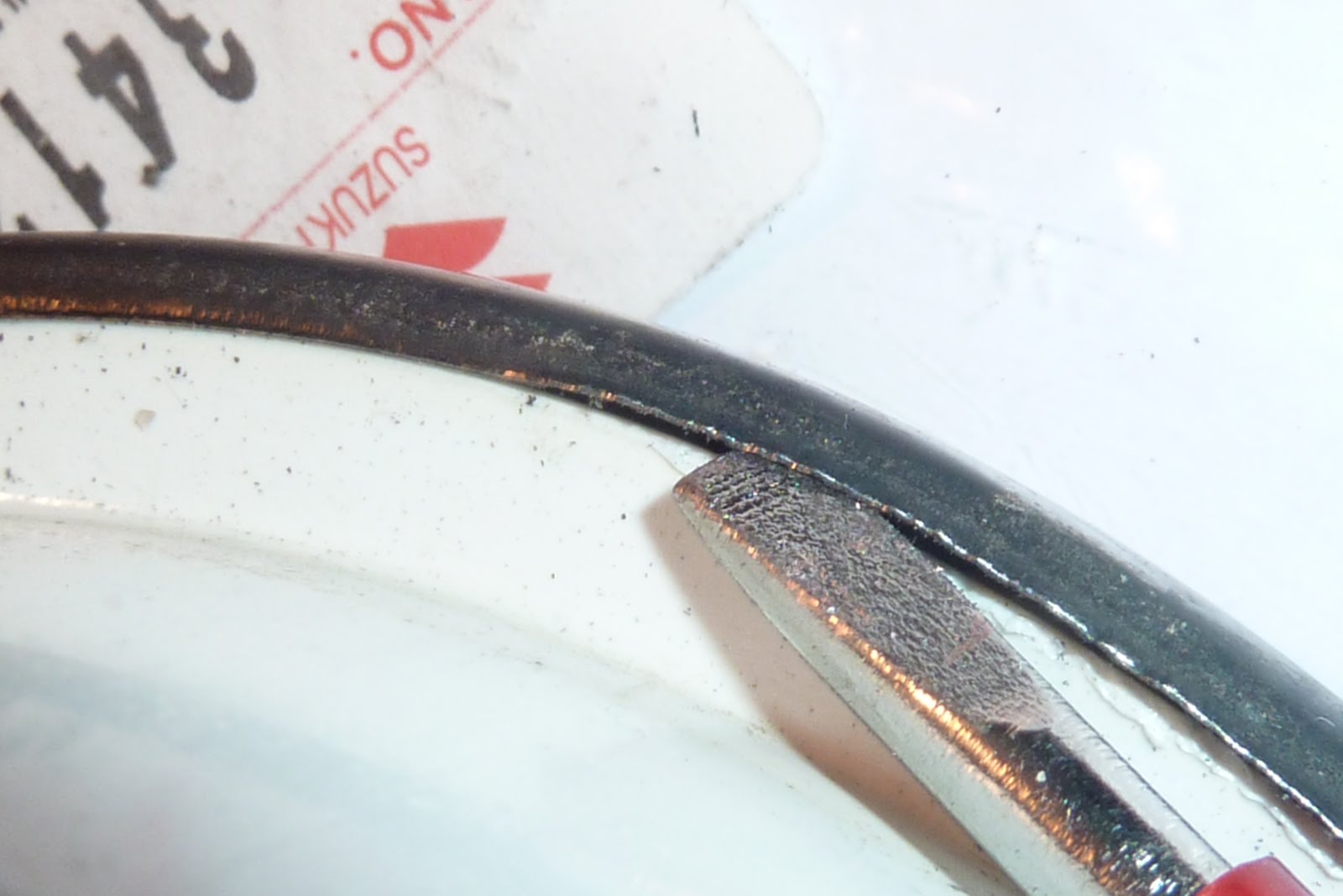

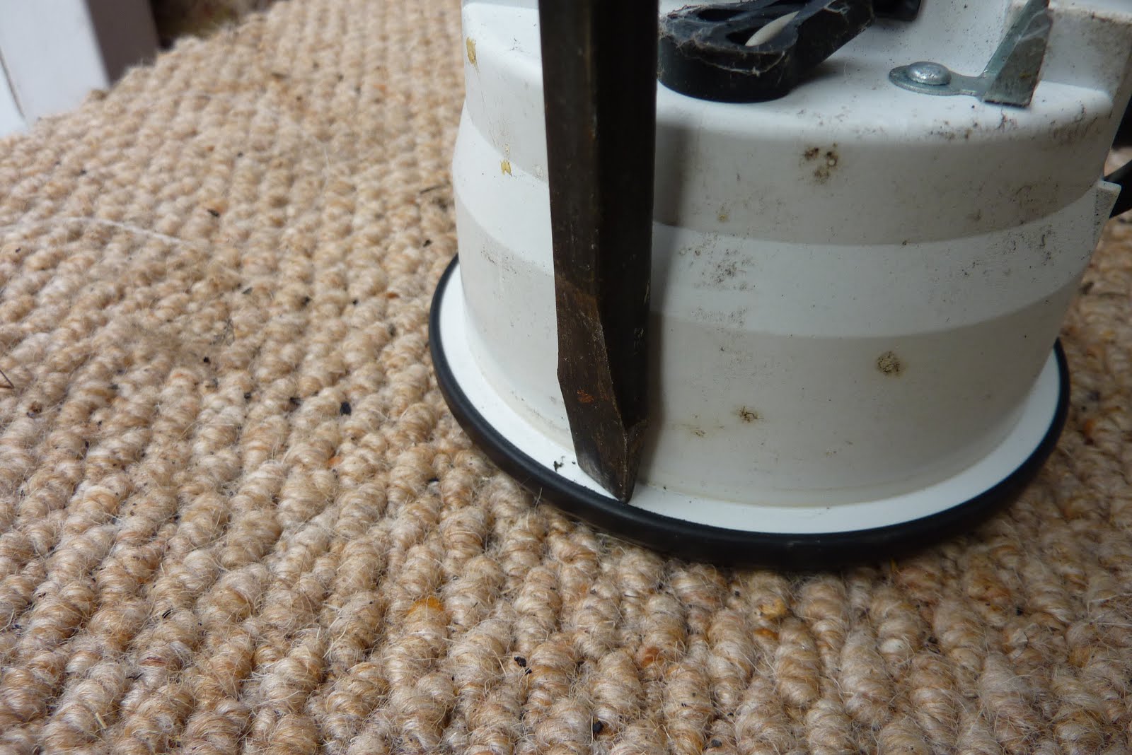

      Pretty standard for these screws to come out. Mine came out between 17,069 miles and 17,187 miles:
      Take the bezel off gently, thread lock/loctite the screw back in, do the same with the other one, clean up the glass and fascia, bung it back together.

        Picture speaks a thousand words. Now if I could just find an adapter cable for my box brownie

          Great pics!
          Same thing happened to my GS850. Right after it turned 100,000 miles, one of the screws fell out on the speedo face. Soooooooo incredibly annoying.
          I used a smaller screwdriver than shown in the pics. Take your time and it's not all that hard.
