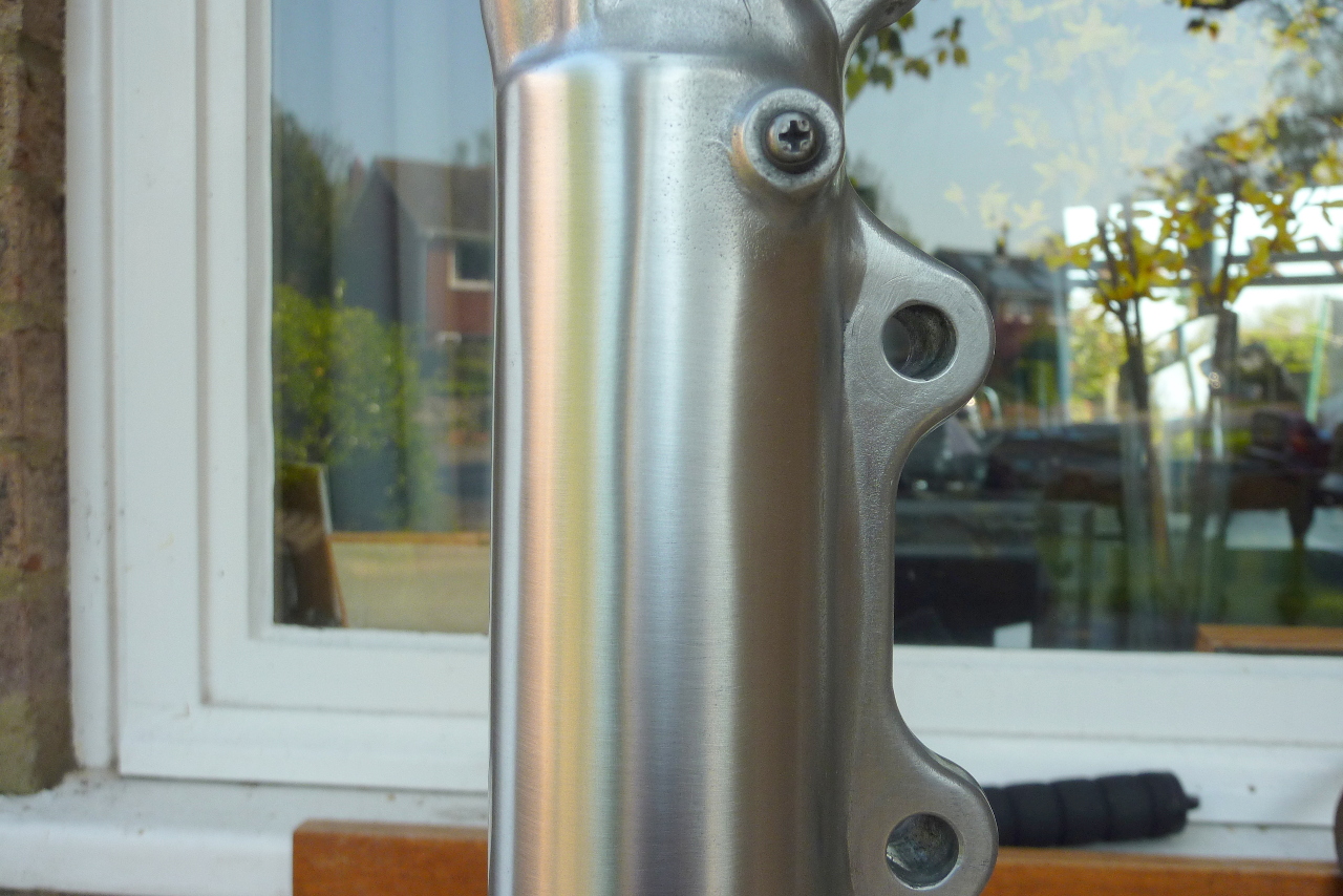

      Day 262 Lower Fork Tubes Polished and Brushed Finish
      Got to work on the fork tubes and I was really surprised at how quickly they came good. I think the problem is that they look worse than they actually are. The clear coat on them traps a little moisture and it turns nasty
      See: My GS1100 Blog - Fork Tube Polish (HD pics)
      These were my fork tubes:
      I firstly stripped all the coating off using VHT Aircraft Strip. Then using a brass wire brush on a Dremel, some 600 grit (wet and dry) and then the green Scotchbrite, I got it looking like this:
      You have to only brush it in one direction - horizontal.
      I was so pleased with this result (and some of you are now going to think I'm weird and some of you will know where I am coming from!) that I could not allow this piece to leave my sight and I took it to bed with me just so I could lay eyes on it first thing in the morning!

        Fantastic result! That's got to be motivating.

                      Those fork tube look awesome! I'm going to have to do the same thing to mine, i'm not very patient and it would be so much easier to just buy new ones, but this bike has some sentimental value so i'm just going to take my time and do it right
                        What I did took only about an hour and a half. Get some decent paint stripper, some 600 grit and a green Scotchbrite, put the radio on and enjoy.
                          Oh Lord, I am completely lost.
                          Greetings
                          Impressive work!

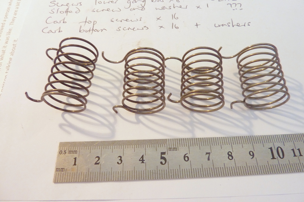

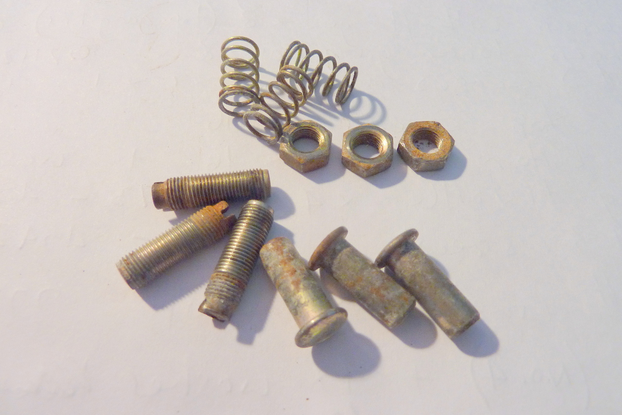

                              Parts for Plating
                              At some point you have to get all the parts together that you want to have plated. And there are lots of them. I have already taken the bike apart and cataloged and boxed most of them. Now I have to get them all out again. Well I didn't get vary far.
                              I want to start putting the carbs back together so I started with all the parts for those and a couple of other bits.
                              Here's my box:
                              See if you can find the 4 things that don't belong to the carbs.
                              The box includes stuff like this:
                              More pics at: My GS1100 Blog - Parts for Plating

                                #270
                                all those screws,bolts and nuts i would replace with stainless rather than get them plated, but thats just me..........
