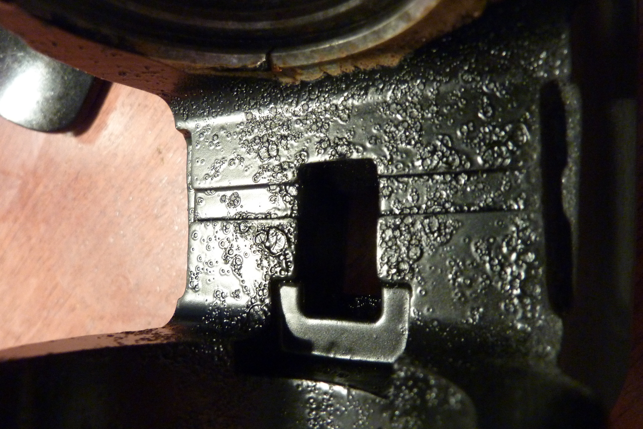

                  Still getting paint problems.
                  Help me out here guys. The powder coaters said they wouldn't paint them so I had another go myself and it still bubbled up:
                  See my GS1100G Blog - Caliper Painting Problem
                  I ultrasonically cleaned them as well this time round.
                  Here they are painted:
                  and then after curing:
                  I think it is oxidation in those areas. I either need to vapour blast them first or bake them in the oven to make sure the oxidation is not holding any moisture. What do you think?

                    they are reacting with something. get them dipped in an acid bath.

                      I've got some Brick Acid which I think is 18% hydrochloric. Will that do? Or where do I find some who can dip them for me?

                        I have no experience, but I think I read somewhere paint should be cured in steps increasing the heat each time? or possibly it says 200f and youre cooking 200c ?

                          #297
                          might be ok, i had a load of stuff dipped at a local speedy strip once. they do anything from wooden doors to wrought iron gates. only charged me a couple of quid to soak the parts for an hour. came out like brand new
                          1978 GS1085.
                            #298
                            ditto on this one. i had the same problem
                            i think you have too much paint on vs curing time / temperature.
                            either apply thinner coats of paint and bake after each one OR
                            apply as much paint as you have done - that's quite a thick coating you have there - then leave to dry for a few days before baking. when you do bake it, do it on a lower temp but over longer time

                              My first thought was your paint was too thick. Multipile thin coats is better. Mind you I'm not an expert. I'd use a solvent based product before I use acid to clean. I'd fear etching the machined areas.

                                I use a degreaser (simple Green) and a scrubbing brush, then wash in very hot water, air dry with compressed air and then blow dry till all moisture is gone and paint while it's still warm.
                                I use VHT Caliper Paint Satin Finish and cure at 200F for 1 hour per the instructions.
