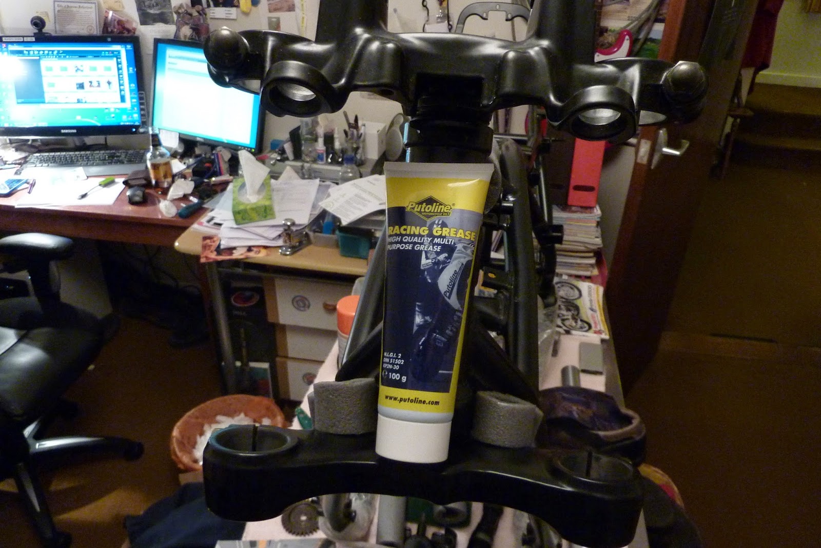

          Steering Stem Mock Up Day 848
          Yes it has been a while. Got distracted by 2 other bikes (see my Signature). I had put the frame away in the loft (attic) for safekeeping over the summer and I have just retrieved it and it's now in my home office where I have made an indoor workshop for it.
          See my blog: Suzuki GS1100G Steering Stem
          First job is to pack the bearings with grease.
          See you soon - I promise.

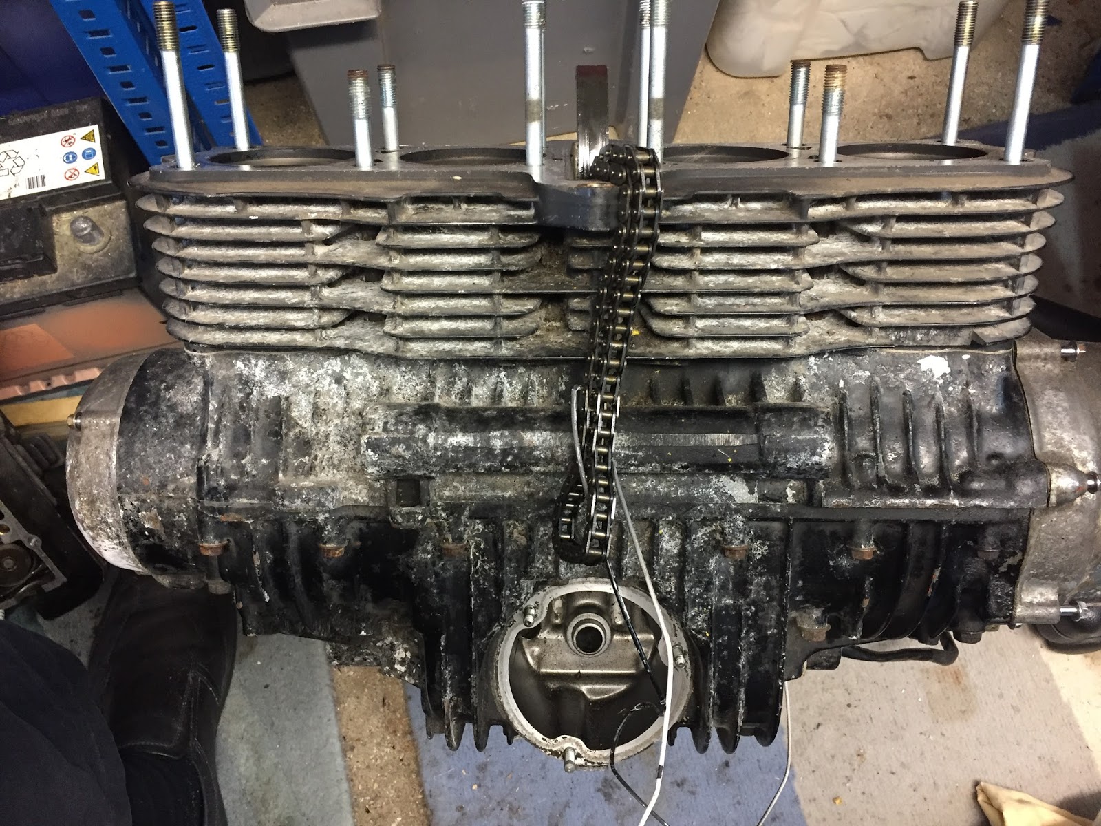

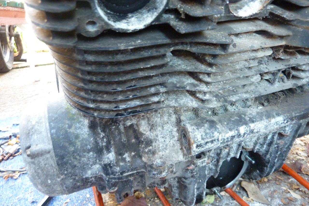

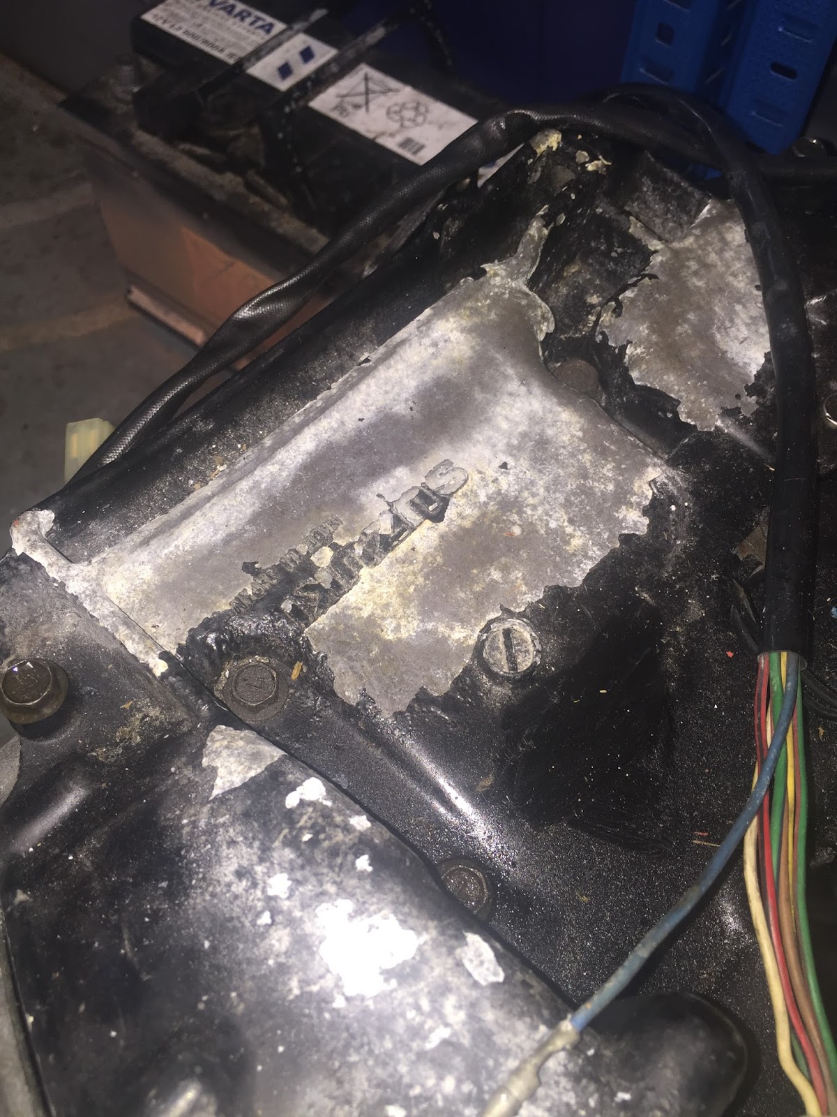

                        This project has been stalled for too long. I could not find a way of cleaning up the engine - it is so corroded. So it has to come apart.
                        See my blog posting: Engine Comes Apart
                        Look how bad it is:

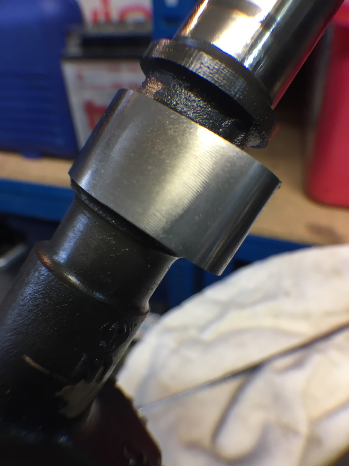

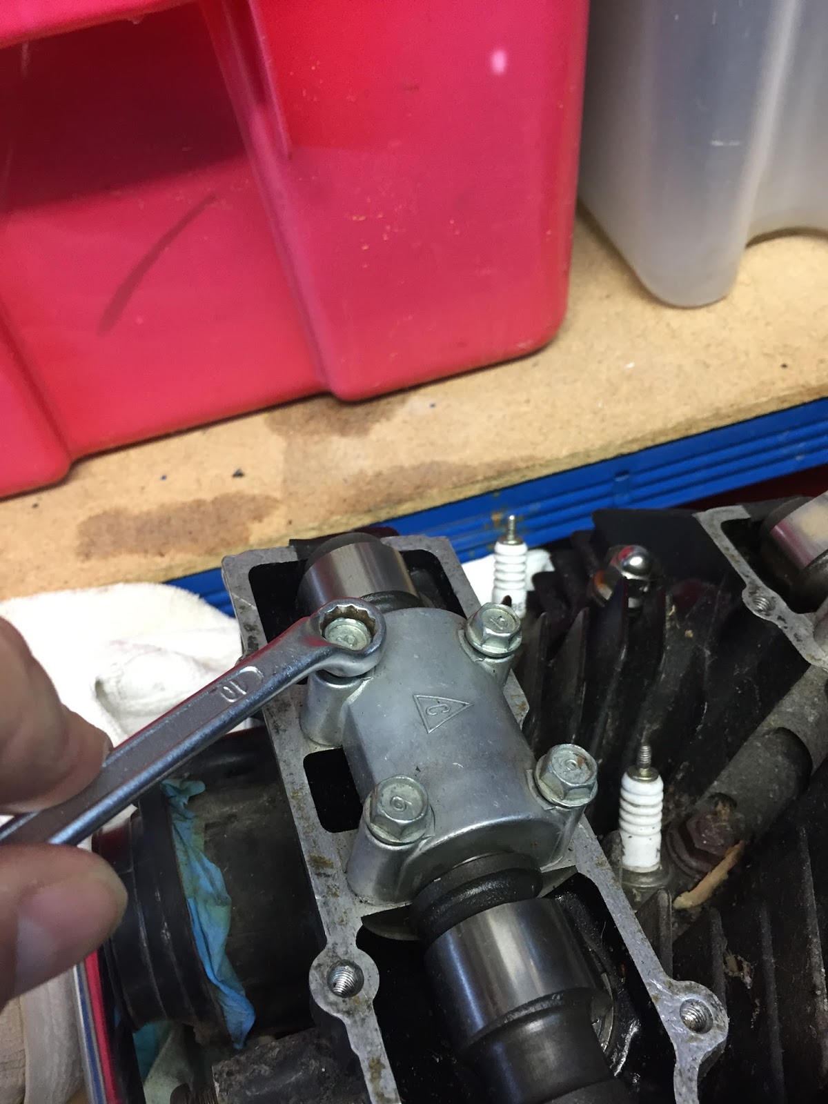

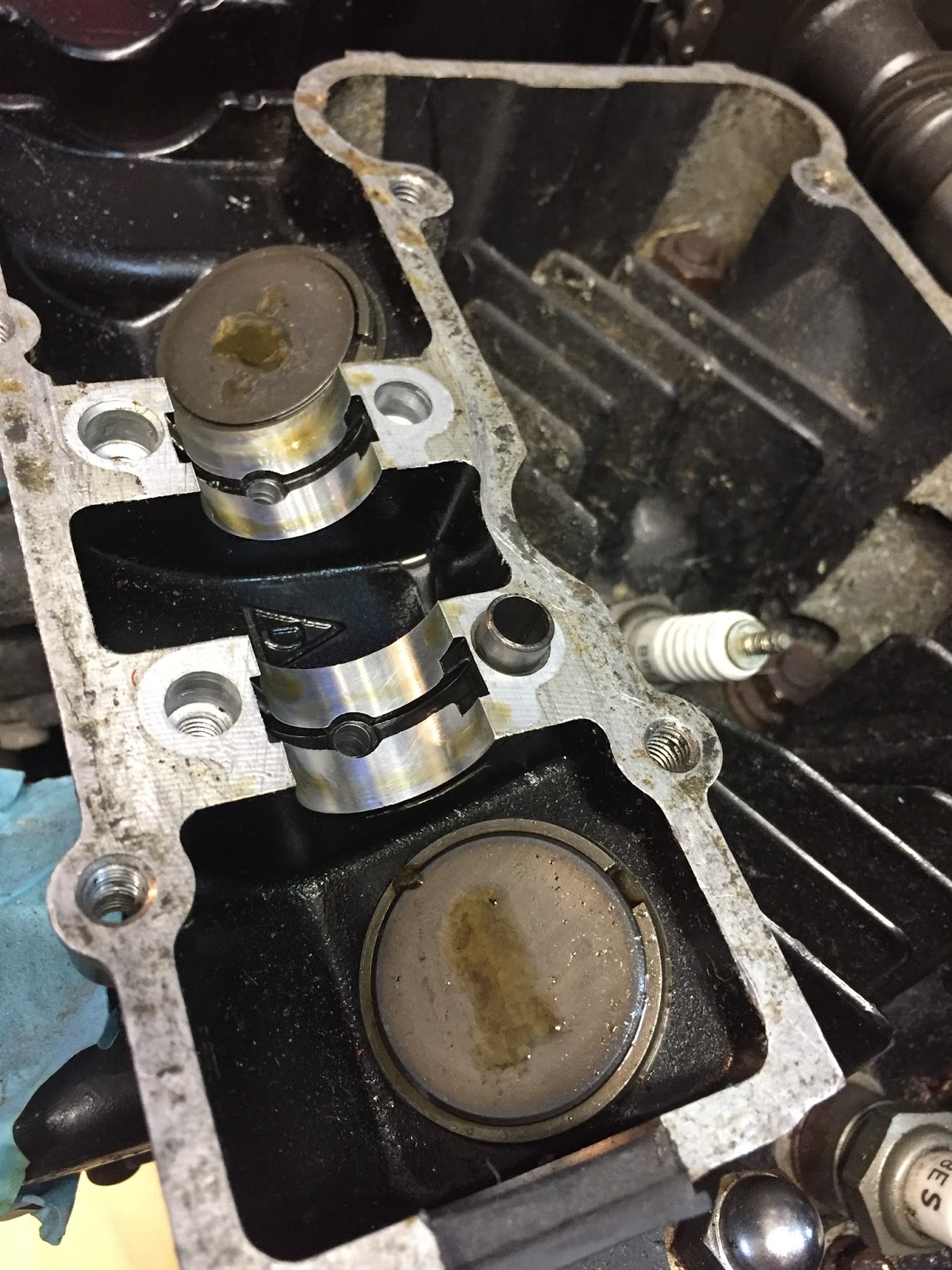

                        It had to come apart to be vapour blasted and re-painted. So I start with the cams:
                        The cams and journals are in tip top condition:

                            That is the worst corrosion I've ever seen on an engine.

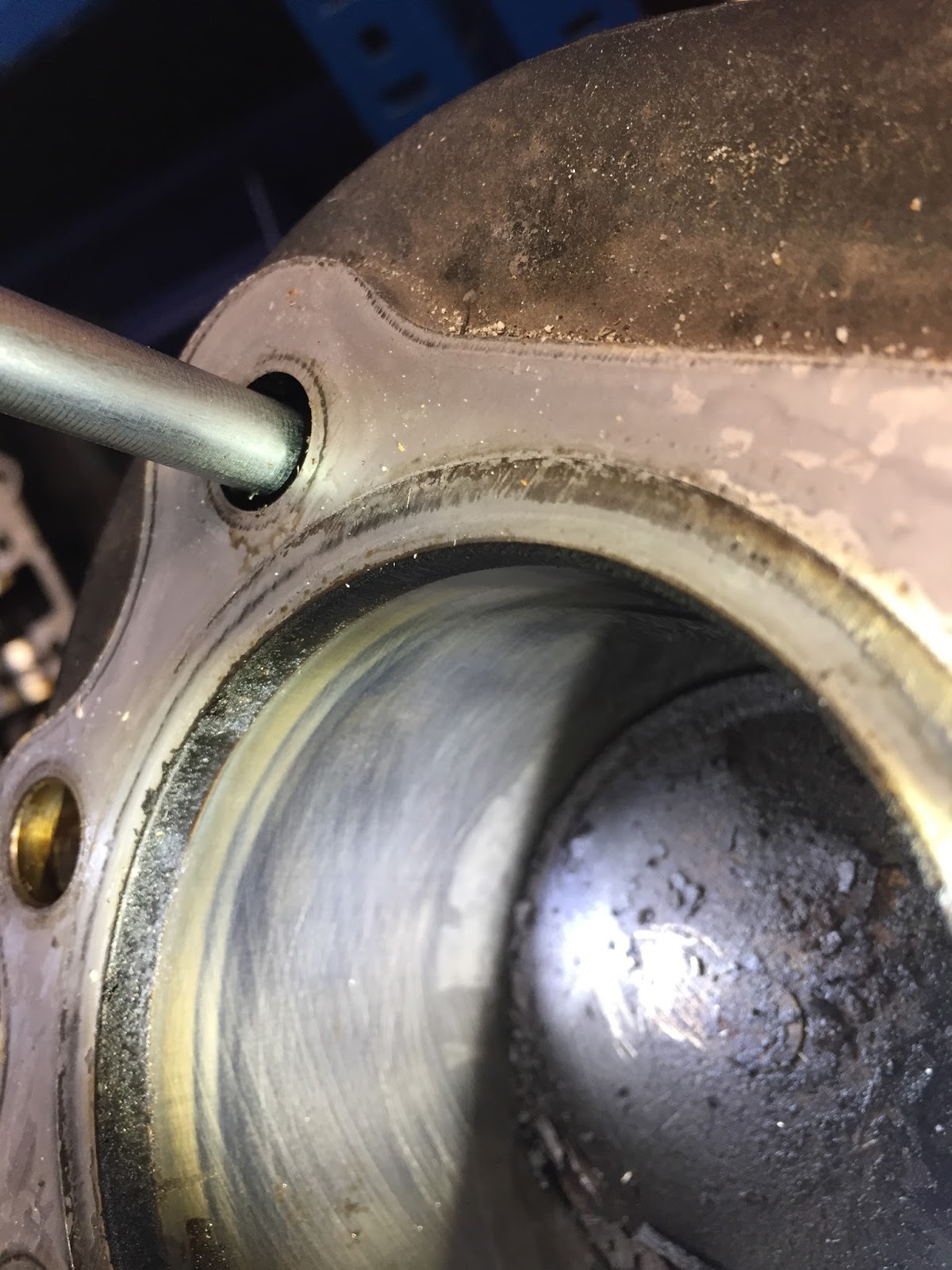

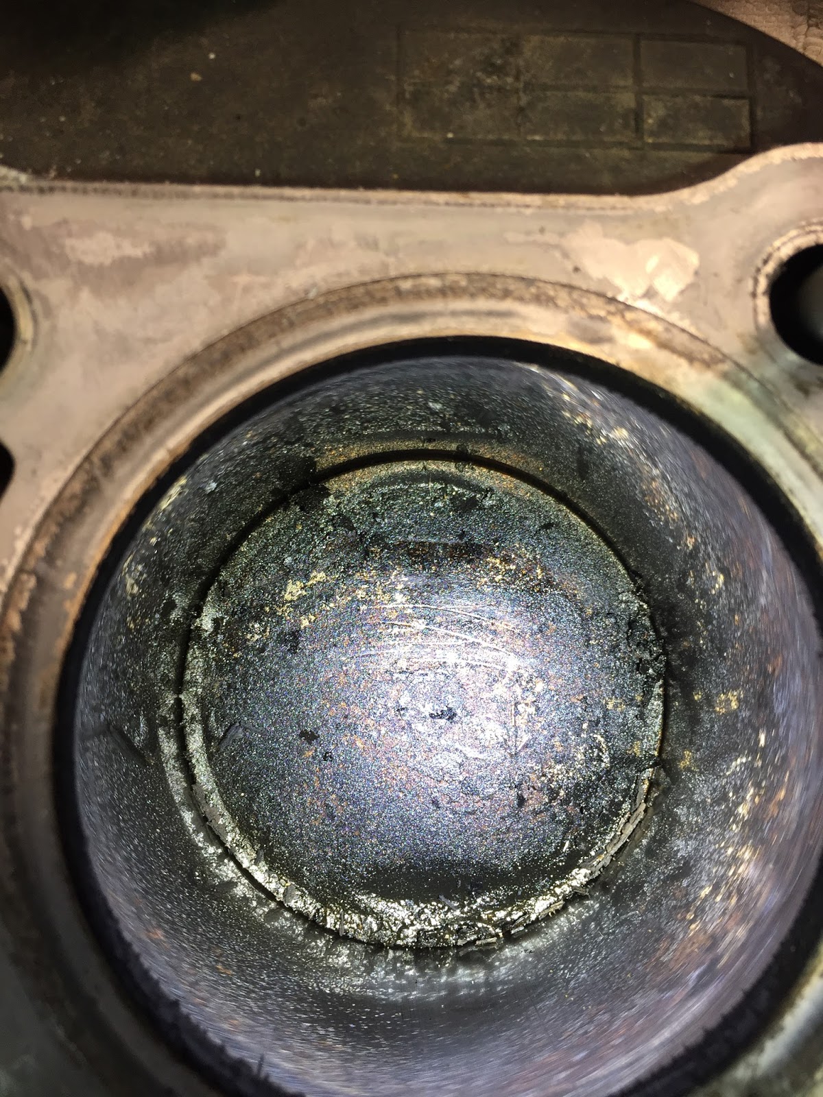

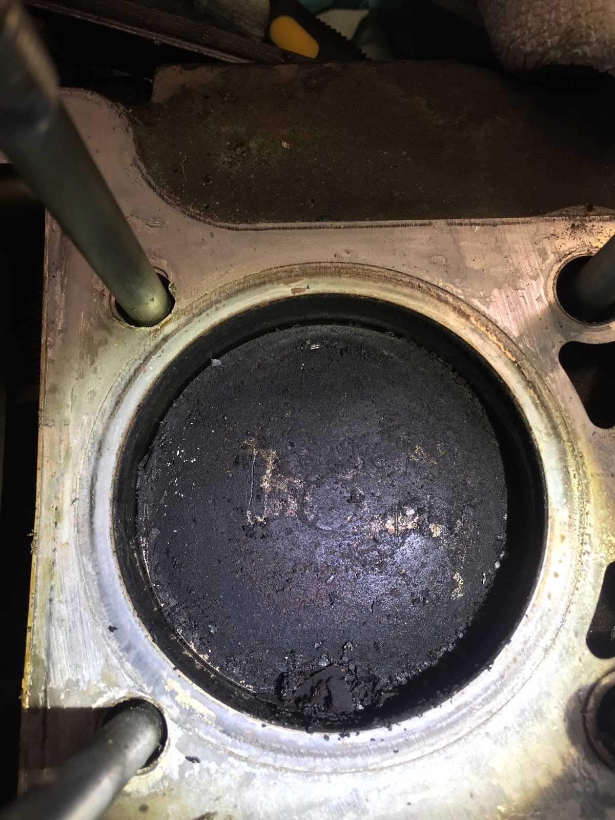

                              Now the heads come off. All the nuts came off quite easily but I had sprayed them with WD-40 a few days ago.
                              I was surprised by the amount of carbon build up given this was such a low mileage bike (17,000 miles maybe):

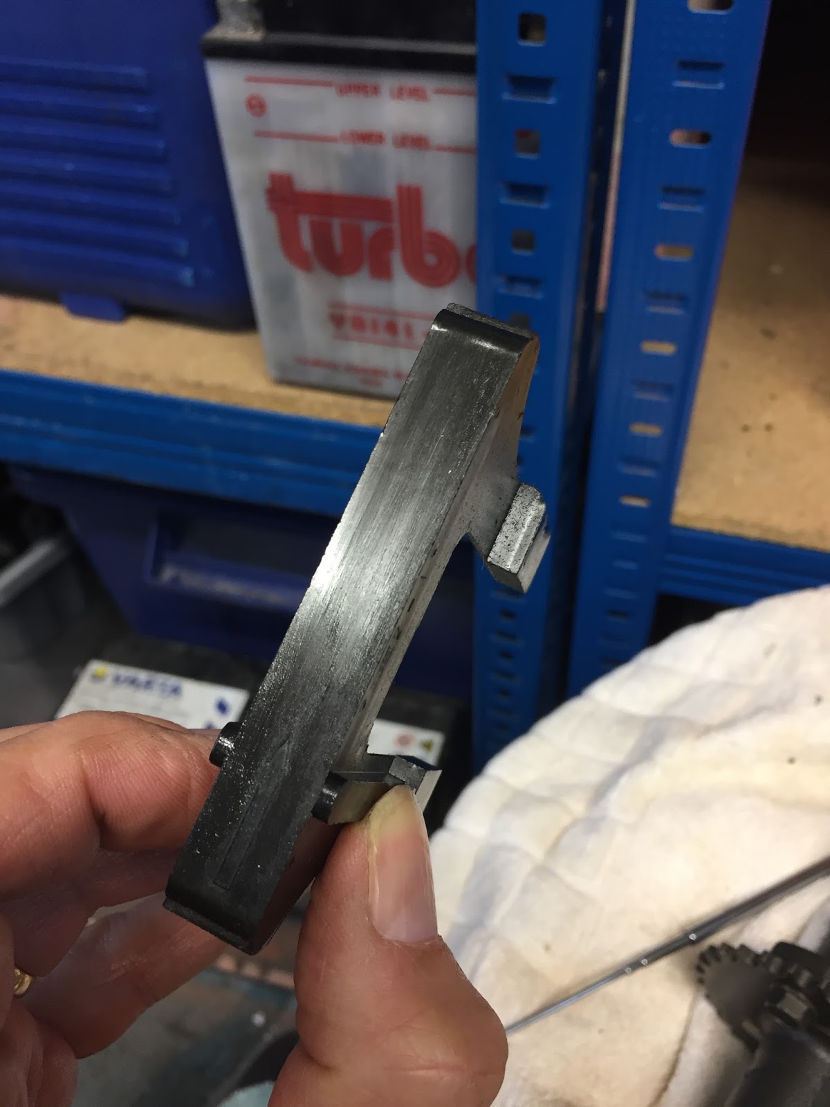

                              But honing still showing through:
                              Cam guides show little signs of wear:

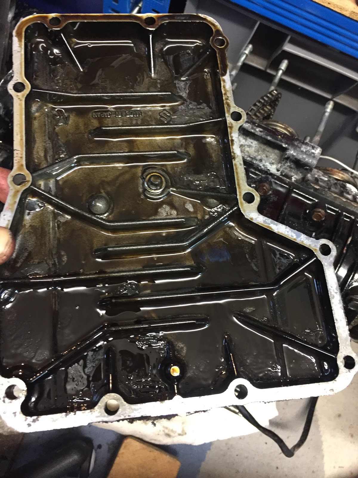

                                Sump Comes Off (Day 1,523 of the build - how bad is that?)
                                I can't believe I started this project 4 years ago. I didn't fall out of love with bikes or anything like that. I just got diverted by the other 5 bikes I bought. I now have 7!
                                So this project, restoring my Dad's bike (originally bought in Canada but now in the UK) started 4 years ago but it triggered a whole new passion for bikes. The next thing was that I was buying bikes that I could ride so this project got put on the back burner.
                                Well this winter I'm rebuilding the engine. I am getting back on track.

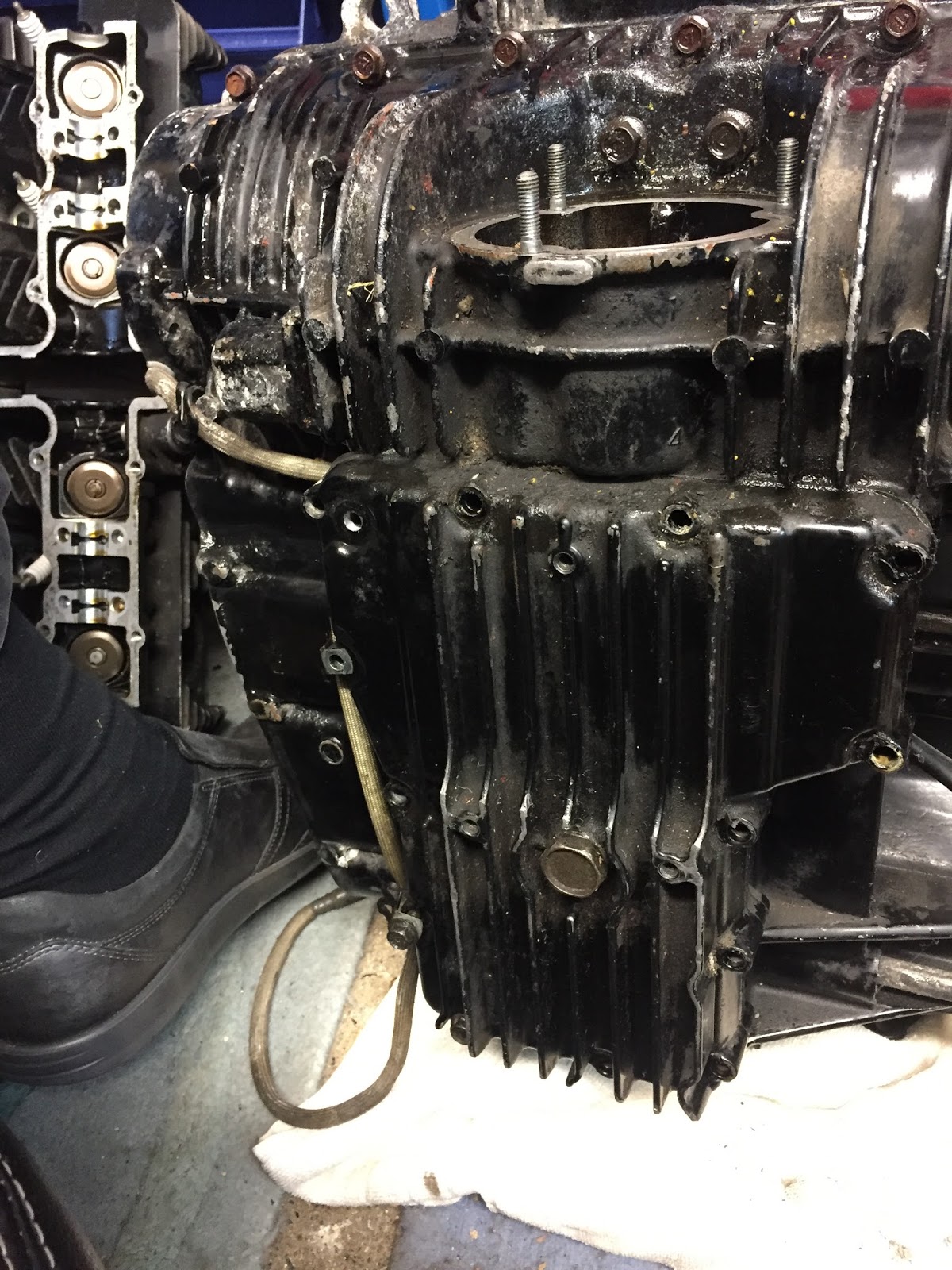

                                See my blog post: Sump Comes Off

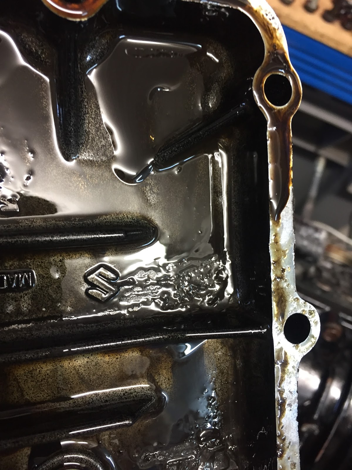

                                I took the sump off. Everything has to come off for the vapour blasting:
                                There was some coagulated oil but nothing to worry about.

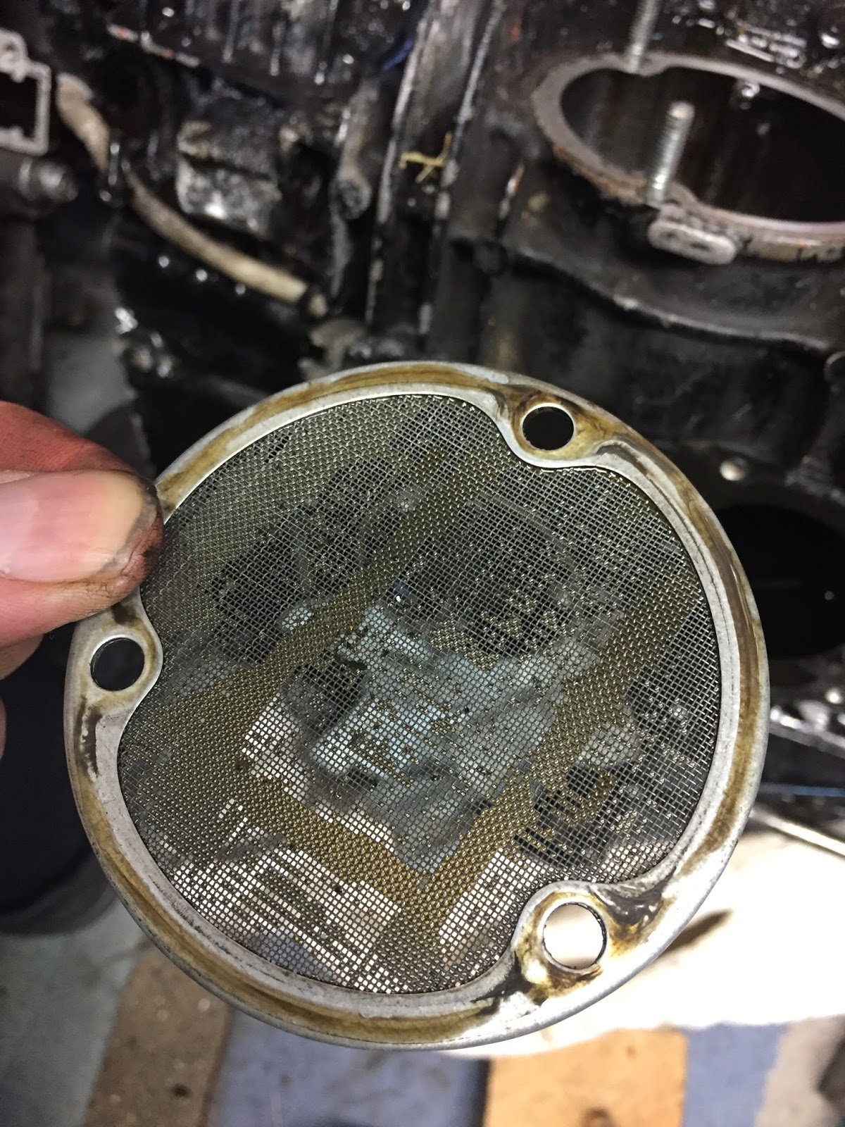

                                And nothing in the sump filter either:
