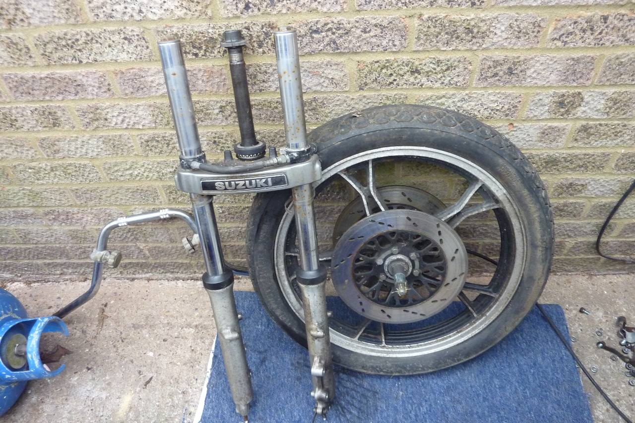

                              Day 214 Front Fork Removal
                              Finally got around to removing front wheel, forks and fork stems.
                              (Yeah OK this is a little out of chronological order but I just realised that I had not posted my fork removal process)
                              See: My GS1100G Blog - Front Fork Removal
                              Propped the bike up with a gas canister:
                              Loosen the fork tops before you undo anything else:
                              Take off top T:
                              Remove retaining collars:
                              And slide the complete fork unit down and out:
                              Check bearings:

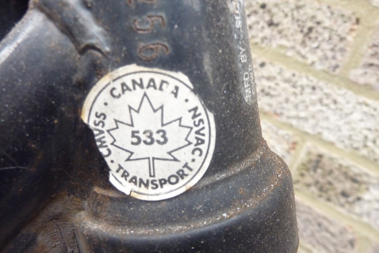

                              And my little Canada sticker - don't want to lose that!

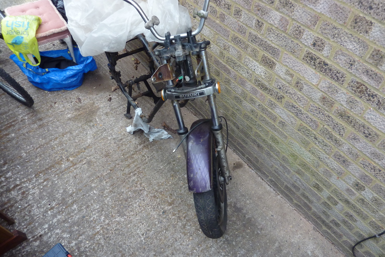

                                Cheap front end, not sure if these forks will really match, but the seller seems to think so
