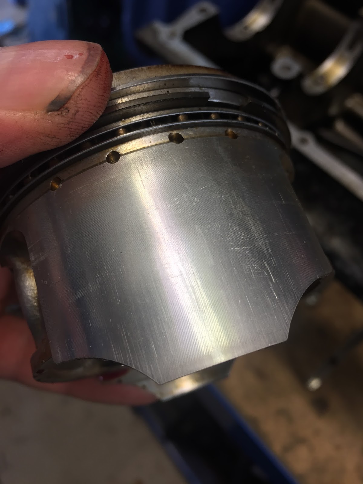

So the engine has to be completely stripped to be blasted and cleaned up. Some thing I didn't really want to do but since I have started it, I'm glad I'm doing it; it is so bad it's the only way to go.
Crank came out nicely. Pistons were very sooty for such a low mileage machine.
But skirts pretty much unmarked.

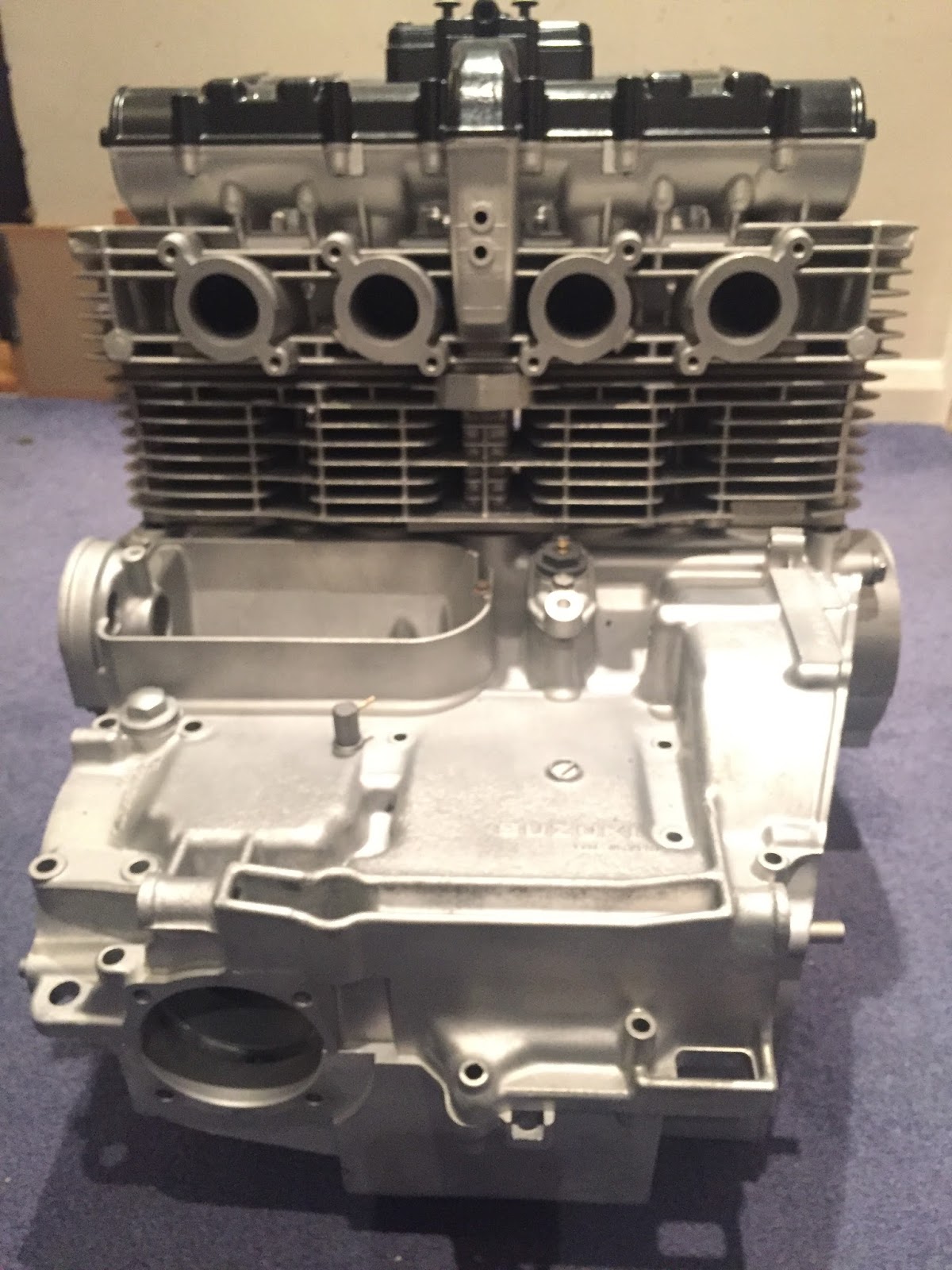

Day 2,324 - The Return of Vapour Blasted Parts
OK it has been a while.
But here are the vapour blasted engine parts. Still need some sanding where the corrosion took hold but it's progress.

Those parts look nice of course but hope the blind oil galley passages in the head were plugged up before blasting. I made the mistake of not plugging them on one blast job and it took me a long time before I was confident there was no longer grit in the passages. It might have been easier to just drill out the plugs and then use a brush.Ed
Originally posted by Nessism View PostThose parts look nice of course but hope the blind oil galley passages in the head were plugged up before blasting. I made the mistake of not plugging them on one blast job and it took me a long time before I was confident there was no longer grit in the passages. It might have been easier to just drill out the plugs and then use a brush.
Do you mean in these passages?
Richard
GS1150 EF bought Jun 2015
Oh I've just had a look. There is piles of media down there.
This is going to be a big job. Might just get those plugs drilled out.
Richard
I also made that same mistake and wow, what a PITA getting all that media out. Good thing these engines are bullet proof. Only time will tell if I didn't get it all out, but so far, so good.Larry

Originally posted by londonboards View PostNo they weren't unfortunately. Yes, now you have mentioned it, who knows what's lurking in there.
It shouldn't be hard to drill out the plugs and thread the passages for plugs. Or you could turn some plugs if you have a lathe. Failing that I'd get some brake cleaner down those passages because residual oil will hold onto the grit. You need to degrease really well before the grit can be washed out. Maybe try bending the shooter straw on the brake cleaner and see if you can get it up into the passages? It can be done, it just takes time and care.Last edited by Nessism; 12-29-2018, 11:22 PM.Ed
