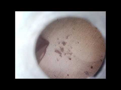

              Those parts look nice of course but hope the blind oil galley passages in the head were plugged up before blasting. I made the mistake of not plugging them on one blast job and it took me a long time before I was confident there was no longer grit in the passages. It might have been easier to just drill out the plugs and then use a brush.

                #367
                No they weren't unfortunately. Yes, now you have mentioned it, who knows what's lurking in there.

                  #368
                  Oh I've just had a look. There is piles of media down there.
                  This is going to be a big job. Might just get those plugs drilled out.

                    I also made that same mistake and wow, what a PITA getting all that media out. Good thing these engines are bullet proof. Only time will tell if I didn't get it all out, but so far, so good.
                      Do you mean in these passages?
                      YES!!!
                      It shouldn't be hard to drill out the plugs and thread the passages for plugs. Or you could turn some plugs if you have a lathe. Failing that I'd get some brake cleaner down those passages because residual oil will hold onto the grit. You need to degrease really well before the grit can be washed out. Maybe try bending the shooter straw on the brake cleaner and see if you can get it up into the passages? It can be done, it just takes time and care.

                        #371
                        Vapour Blasting Horror
                        Can't believe the stuff that's come out of my oil passageways after vapour blasting.
                        So I decided to drill out all the plugs in the cylinder head to expose the evil. Especially the dead end passageways.
                        A mate of mine, spun up some replacement plugs and I sent the engine to be painted.
