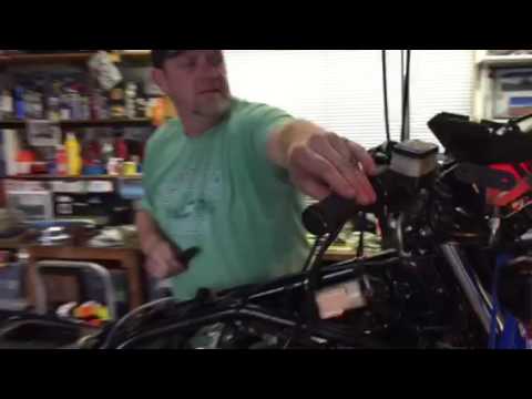

                      Well a little update....Carbs were leaking big time when we put them back in....Rob used his new can of Berryman's dip and it sorted it out.
                      Also the cam chain timing was out one pin....Rob fixed that too...
                      And Mark helped out yesterday with tuning the carbs....Sounds great!!! Now over the weekend I will get the other pieces back together..
                      Thanks so much to Mark and Rob....there is no way I could have done this on my own....I am in awe of their talent and willingness to help me.

                        Is that with the 33mm Mikuni smoothbores on the bike? The throttle response sounded pretty good, my 33's have a tendency to hang the revs.

                          No Glenn, those are the stock carbs...yeah, the response is very good!

                            Ah-ha! I should have known when I saw the sync tool, you can't use a sync gauge with the 33's.
